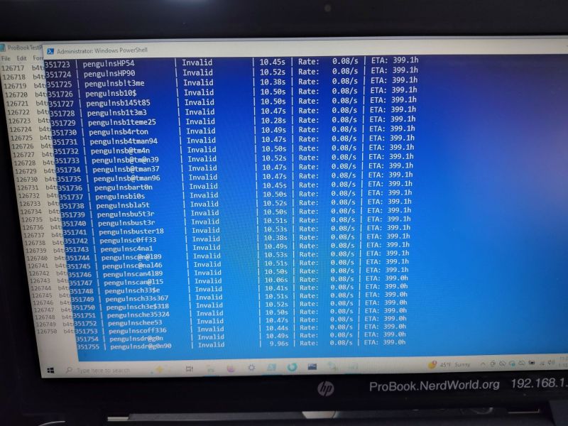

Project Fail: Cracking A Laptop BIOS Password Using AI
Whenever you buy used computers there is a risk that they come with unpleasant surprises that are not of the insect variant. From Apple hardware that is iCloud-locked with the original owner MIA to PCs that have BIOS passwords, some of these are more severe than others. In the case of BIOS passwords, these tend to be more of an annoyance that’s easily fixed by clearing the CMOS memory, but this isn’t always the case as [Casey Bralla] found with a former student-issued HP ProBook laptop purchased off Facebook Marketplace.
Maybe it’s because HP figured that locking down access to the BIOS is essential on systems that find their way into the hands of bored and enterprising students, but these laptops write the encrypted password and associated settings to a separate Flash memory. Although a master key purportedly exists, HP’s policy here is to replace the system board. Further, while there are some recovery options that do not involve reflashing this Flash memory, they require answers to recovery questions.
This led [Casey] to try brute-force cracking, starting with a Rust-based project on GitHub that promised much but failed to even build. Undeterred, he tasked the Claude AI to write a Python script to do the brute-forcing via the Windows-based HP BIOS utility. The chatbot was also asked to generate multiple lists of unique passwords to try that might be candidates based on some human guesses.
Six months later of near-continuous attempts at nine seconds per try, this method failed to produce a hit, but at least the laptop can still be used, just without BIOS access. This may require [Casey] to work up the courage to do some hardware hacking and erase that pesky UEFI BIOS administrator password, proving at least that apparently it’s fairly good BIOS security.

  5. Could have just done the smart, obvious thing and used a TSOP clip and a CH341A to flash out the password instead of wasting nearly 2 months on AI bullshit to no good result.
    1. Please, point out the instructions to do that on this specific laptop, instead of just “hey you can connect some wires and use some magic code that I assume exists but I’m too lazy to look for”.
      The smart, obvious thing is not to make comments this pointless.

  6. This isn’t really using AI to crack the BIOS password as much as it is vibe coding a python script to do a standard brute force attack.
    1. You are exactly correct. AI just helped speed up the python coding.

  7. So, HP Probooks do have a backdoor for this, but it’s not a “master key” as each laptop requires a unique key file that qualified technicians and partners can request from an engineering team within HP. The process is basically “Put the file on a flash drive, plug it in, turn the laptop on, go into setup and change password.”
    Consumer models (Compaq models, Pavilions, etc.) have a different method that is (mostly) universal but requires nonpublic software.

  11. Uh everyone here is about 10 years behind. You can’t just pull the bios or reflash it. The password is no longer set/stored in the bios chip on any modern HP computer, laptop or desktop.
    Please do a Google search on ‘trusted enclave’ and read up a little on the tpm module. In short, your bios password is stored in the secure/trusted enclave. On most modern systems your bios password is stored there along with a complete copy of the bios. On startup, the computer system veries the bios and is completely capable of fully restoring it from the enclave to ensure a ‘secure’ boot. And no, this is not a separate backup bios chip on the motherboard (although HP sometimes has two ‘bios’ chips) This is most times embedded in the chipset/CPU. (Hence why HP recommends a complete board replacement…not too many people can replace a bga or get access to the chip) You can literally completely wipe the bios chip, reinstall it and have the computer restore it, without outside help, to its previous state (I have, in desperation, proved this fact 4 years ago – do not ever let former employees set a bios password on their computer – set it for them before allowing access to the computer!)
