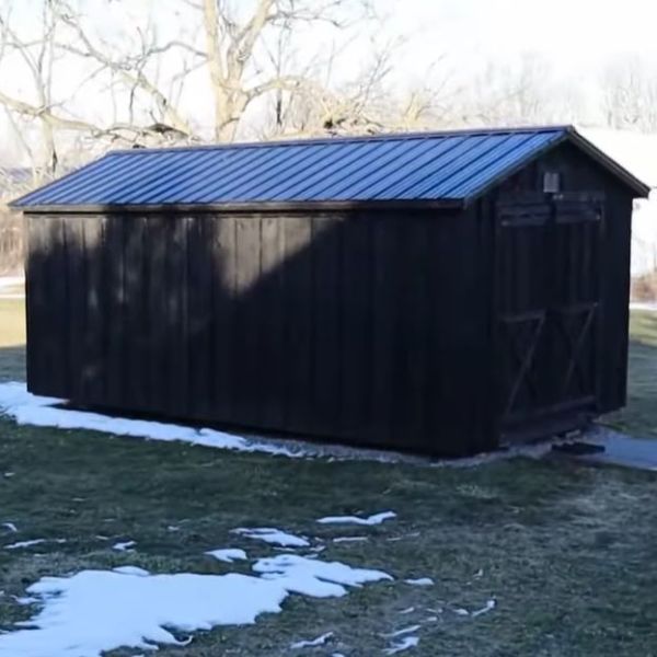

Most people see that garden shed as little more than a place to store some gardening tools in, but if you’re like [Dr. Semiconductor], then what you see is a potential cleanroom for semiconductor manufacturing. As ridiculous as this may sound, the basic steps behind the different levels of cleanrooms work just as well for a multi-million dollar fab as they do for for a basic shed.
Key to everything is HEPA filtration along with positive pressure, to constantly push clean air into the cleanroom, while preventing dirty air from flowing in. The shed was also split into two sections, the first room once you enter it being the the gowning room. This is where you change into cleanroom gear before you transition into the cleanroom.
In addition to the flame-resistant drywalls, a water-based epoxy coating was applied to the insides of the cleanroom walls to make it smooth and free of debris. The HEPA filtration system constantly filters the shed’s air along with some fresh outside air, while an airconditioning unit ensures that the temperature remains constant.
The measured >0.5 µm particle contamination inside the shed turned out to be enough for a FED STD 209E equivalent of Class 100, which is ISO 5 class with a maximum of 3,520 particles/m3. For comparison, room air is ISO 9 with max 35,200,000 particles/m3. At ISO 5 it’s good enough to do some semiconductor R&D laboratory things, which is what [Dr. Semiconductor]’s channel is – shockingly – about.

  4. I am impressed. Having worked in clean rooms at the reported level it’s not something I would want to do at home. Every time you have to pee you have to do a 15min suit down in an airlock and a suit back up. I am skeptical this design is as stringent as the rooms I worked in because the air lock has a flappy door. We also were more suited up believe it or not. 2 layers of everything. Had to get blasted with air before entering and even leaving. My guess is those measurements are close to the best case, ex room hasn’t been disturbed for half an hour. Regardless I am impressed both by the build but also the desire to have something like that at home.

    1. Actually, we did this same thing (almost) in the mid 1980’s when we were building a FAB. Ours was used for producing ultra-clean fittings for the initial Tool installation of their the Class 10 Cleanroom, and if I recall correctly, we got our little building down to Class 100 also.
      Our Garden Shed (And that’s what it started life as), had the same layout except the scratch-filter covered HEPA filters, were on the end wall (not the ceiling) for horizontal laminar flow. A sheet metal cowl, fed by a large squirrel-cage blower, covered the filters and fed them air. The over-pressure was sufficient to prevent contamination from outside. Rather than chip making equipment, a stainless steel tank1 with heated “Trike” (Trichloroethylene), was used for cleaning pipe and tube fittings to “Oxygen-Clean” standards. Trike was later considered too dangerous to use in this manner (they’d used it for years to flush the Saturn 5 engines on the launch pad which, I understand, eventually made the pads into a Superfund site!). Class 10 was state of the art at that time. MIT told me they’d been building a Class 10 Cleanroom for three years (we had 18 months), and NASA and JPL told me even their cleanest optical payloads were usually at Class 1000, seldom Class 100.
