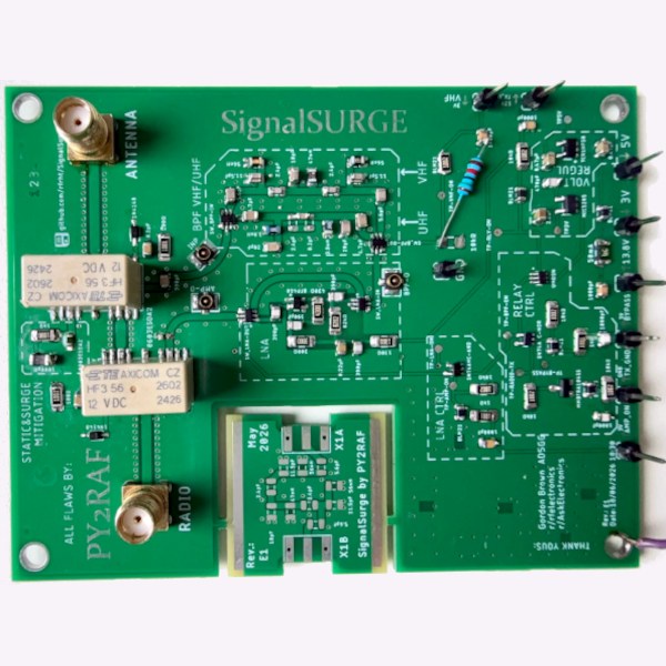

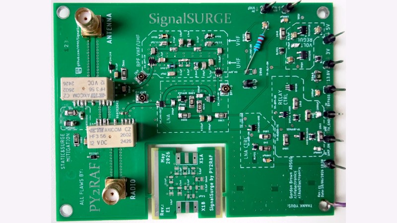

It’s an unfortunate side effect of proximity to a large transmitter that the received signal can overload a receiver’s front end even when tuned to other frequencies. [Rfrht]’s had this problem with nearby FM broadcast transmissions overloading the 2 metre and 70 centimetre amateur bands. The solution?  Design and build a bandpass filter. This allows the signals you want to pass through while rejecting or attenuating out-of-band frequencies. The resulting PCB is very nice indeed.
On board, aside from the filters themselves, are a low-noise preamplifier and relays to switch between receive and transmit. Everything is controlled by logic-level signals. All components are surface-mount, and the PCB layout clearly takes special care with RF routing.

  1. I like the indication of the filters on the board itself. The cutout in the middle is interesting, though. “All flaws by…” is hilarious.
    1. The silk screening is impressive, no doubt helpful when coming back a decade or two later, perhaps the next owner will appreciate it.
      Having miniature connectors, presumably for testing purposes? seems like a good Idea, no doubt the extra cost is more than made up for by making the solid probe connections easier. It’s always nice to find humourous little additions to PCB artwork, but it’s especially nice to find a PCB where everything’s labeled so thoroughly.
