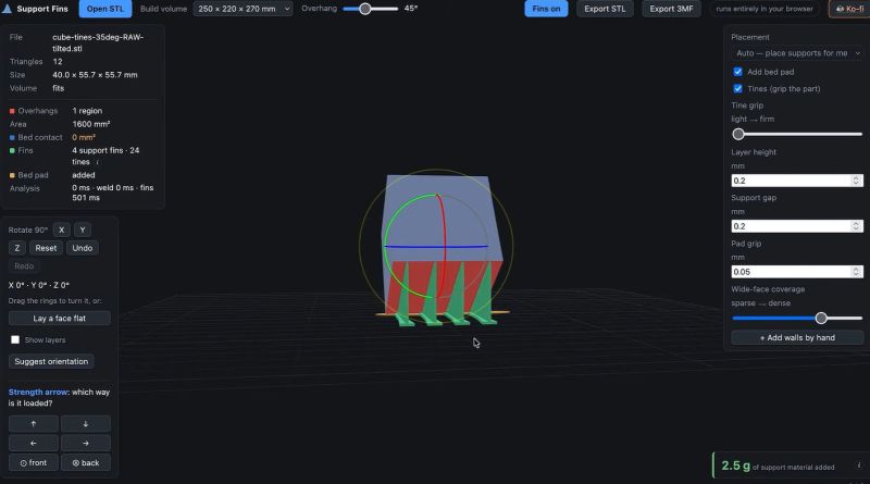

Perhaps one of the most contentious issues in 3D printing is that of supports, both because they’re an uncomfortable reminder of how gravity affects our prints and because the very idea of there being ‘one right way’ is bound to get you into some spirited discussions. That said, [Matthew Trahan] figured that neither regular grid supports nor organic tree supports are the answer here, and that the better answer is found in fins.
The problem with existing support approaches especially with FDM prints is that they can be fairly wasteful in terms of material, and they can leave serious marks on the printed object’s surface that require post-processing. These fins on the other hand are designed to require as little material as possible and snap off as cleanly as possible. The tool, developed with the assistance of Claude, can either run locally or be accessed via printfins.com.
Currently the idea is that these fins are baked directly into the STL model so that it’s a one-time thing, but it may eventually become available as a slicer plugin. The basic concept was pitched by [Slant3D], who gets credited in the video below, although in their approach they used CAD software to add the fin supports manually.
The fins are there to provide the support base, while small tines can be added to reinforce the connection to the model. These do make it less easy to snap off with minimal scarring, of course. Conceivably these fins could be made even more light-weight by adding gaps, but that probably would add to the print time.

  5. I recently ran across this video from clough42 about making a fin support even cleaner to remove:
    https://www.youtube.com/watch?v=1Zocl7n98xY
    “Without a Trace: 3D Printed Supports That Remove Like Magic”
    It involves modelling the support as a separate object and telling the slicer to treat the object slice each independent object (Not sure which slicers can do this, I’m trying with orcaslicer and it seems to work). Once sliced, the two objects touch but are printed as separate tool passes, so they should not be as fully bound as if tines were involved.
    Since printfins.com makes the fins after the fact, it probably does the same thing.
    Coincidentally, I just finished a design and slice for this approach last night (won’t get to trying the print until tonight) for a DeWALT battery cover. I’ll see how it prints, then try running it through printfins.com.
    1. Depending on the printer (mostly on how smooth the x/y motion is), you can also just move the fins one or two layer’s-height – or else one nozzle-width, whichever is greater – away from the model and have it print correctly. (Needing to import it into a CAD software, of course, but not really needing anything more capable than TinkerCAD.)
      My most extreme example is when I was having trouble printing a custom Raspberry Pi case for a project (which had to be printed standing on one edge to eliminate stringing problems and keep the ports at the correct size), and ended up attaching one edge to a 0.2 mm thick raft that was also attached to fins designed to be 0.4 mm away from the model. (I was using a 0.2mm layer height for the print.)
      No stringing, and the model didn’t fall over (as it did consistently without the fins), but that was on someone else’s Bambulab printer. I would likely need to make the fins touch the model if I did it on my old Creality (though I’d rather just drop the print speed and keep the gap).
    2. I realized I’d never followed up with results.
      The “clean removable support” method seemed to work very well, there were slight indentations where the two objects met, but they were smooth.
      Loaded the same base object into printfins.com site and let it auto-generate supports (with the tines). The result also adhered to the bed during printing and was easy to remove. The bumps from the tines looked small enough that they could probably be almost invisible if I bothered to hit it with a little sandpaper and a heat gun. The site was very well laid out and easy to use.
      I didn’t try anything else (like printfins without tines or the clean support method without breaking into multiple objects) because my printer has started globbing with PCTG and I need to get it in tune before trying anything that requires precision.
      When designing my own parts, I’ll probably just spend the few extra minutes to add the supports manually in FreeCAD. If printing a file from just an STL or trying to add supports to a complex surface I’ll really consider printfins site.
