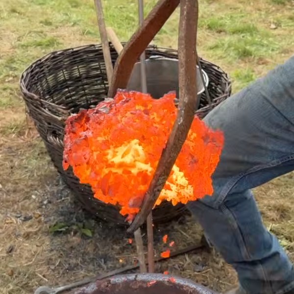

Sometimes along comes a hack with a personal angle, and in a video showing Irish bog ore smelting, we find an appropriate follow up to a Hackaday expedition back in 2019. [Alec Steele] joined Irish Bloomery Iron, for a weekend with a medieval blast furnace.
Our brush with bog ore came in a trip to Hack42 in Arnhem, the Netherlands, where a team of Dutch hackers built a furnace from firebricks in an attempt to do the same thing. The Dutch attempt ended with a lot of mixed slag and very little iron, and looking at how the Irish furnace was constructed we see some clues to their success. Their air injection using a perforated sheet of clay and the air blast injected to form a venturi is particularly interesting,as is the shape of the furnace.
The iron bloom is lifted out through the top of the furnace rather than being tapped as molten iron, and we’re treated to it being worked into a usable bar of iron. Having spent a day with our Dutch friends doing the same work only to have scraps of iron, we’re mightily impressed with the results from the Irish smelters. You can visit their website at www.irishbloomeryiron.com.

There is not a single formula for running a successful iron bloom. The particulars on how to build and operate it depend largely on the composition of the ore. Even the same type of ore from different sources will have different levels of silicates or alloying metals that require significant adjustments. A successful bloom calls for celebration no matter the century.
The ‘from dirt to space’ is sadly one of the many projects which had the momentum killed by the Covid period, and Hack42 moving. I was there at one of the melts in 2019, and it was good fun. I expect we would have gotten iron, eventually. Be it that the bricks are not reusable, and at €5 a piece, it gets quite expensive too.
One part I’m missing in the video above is the safety. Not just are hot things hot, the exhaust is very much only carbon monoxide which can very quickly overwhelm you. At some point at Hack42, the person working on the forge was held by the collar just in case.
