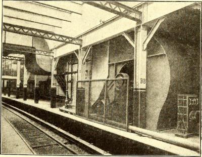

High temperatures have long been a problem at the Brooklyn Bridge station. Pictured is a system that was tested all the way back in 1906, which used groundwater to try and cool the station. Credit: Internet Archive Book Images, no restrictions
Now, typically, when a building gets too hot, we look at using air conditioning to bring temperatures down. However, the unique nature of subways makes this very difficult to execute. Subways have miles upon miles of tunnels that are open to the platforms, so an air conditioning system would just be pumping cold air off into these deep voids to little local effect. Subways are also full of open entrances which don’t help, either. As much as you could try and locally cool areas of the subway, even a bunch of large HVAC units would barely make a dent.

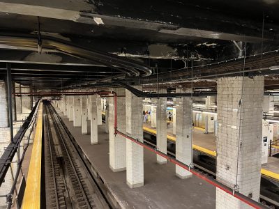

The Chambers Street station has been long overdue for renewal. As part of pending upgrades, a thermal energy network (TEN) will be installed to try and bring down temperatures for commuters. Credit: IliketrainsR211T, CC BY-SA 4.0
A thermal energy network (TEN) is designed to move heat between buildings, taking it from where it isn’t wanted and moving it to somewhere it can be more useful. It involves drilling grids of boreholes hundreds of feet deep into the ground, where temperatures stay much cooler and more stable—as low as 55 °F (12 °C). Pipes are then installed around the subway station that run into those boreholes. Circulate fluid through the station pipes, and the fluid picks up heat from the subway station. That fluid is then run into the boreholes, where it gives up its heat and is chilled, and then the fluid is recirculated to the station to continue the cycle.
Over time, the bedrock around the boreholes heats up, and it can then be used as a sort of thermal battery in winter. Fluid can then be circulated into the boreholes to heat it up, and then that fluid can be pumped to other municipal buildings that need heat in the cooler months.
The technology isn’t new—geothermal boreholes have been used for some time across Europe and Canada as a way to achieve cooling. There’s even a system in Coney Island, where 153 geothermal wells are used to provide comfort for a condo built in 2019. Still, implementing a system big enough to bring down the excessively high temperatures in New York’s subway system could yet prove a challenge. For now, the project is a study to explore whether such a concept could make a meaningful difference to user comfort in the station. If it proves workable, though, expect there to be huge demand from commuters to roll out similar systems across other stations in New York and beyond. The sweaty subway could yet be a thing of the past, merely requiring the engineering and will to do so.
