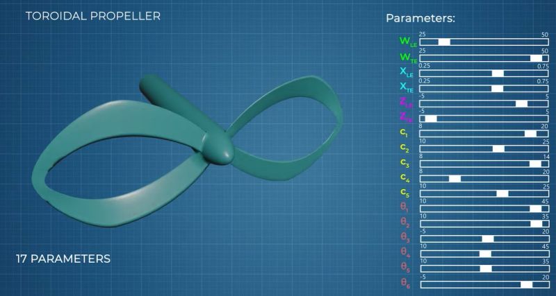

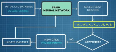

This left figuring out an optimized shape for the toroidal propeller to pit against it. While you can absolutely brute-force the seventeen shape parameters being considered here and test them in CFD, this would take insanely long. The hack here is to use multiple reference frame (MRF) to drastically speed up the selection process, though even then it still took two months. An example of using MRF with regular propellers is discussed in a 2019 paper by [Randi Franzke] et al. in Energies.
Although MRF saves a lot of simulation time, you still end up with a lot of data that has to be analyzed for interesting patterns. For this [Neuronautics] trained a artificial neural network to automate filtering the many options for the most optimal ones, until converging onto a single design.
This G1401 design was the lucky winner, though with only a simulated 62.9% efficiency. Subsequently the one aspect that had been left unchanged was also iterated through, in the form of many different airfoil shapes until the final design appeared.

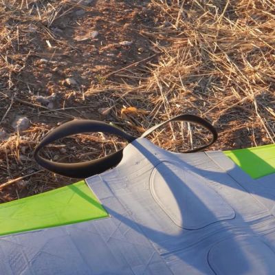

This design was then 3D printed in resin, which showed the first hurdle with the selection process, in that the printed versions were too thin and flexible to be usable as propellers. Cue many hours of manual tweaking of the design to make it actually printable.
Although the final design didn’t exceed 62% efficiency in a final test, the comment section to the video rightfully points out that the comparison was between a commercially made propeller and a DIY resin-printed one, which adds a whole other batch of variables. That said, it’s unlikely that there’d have been an obvious improvement either way, otherwise we’d already have seen toroidal propellers pop up everywhere on drones and aircraft.

Even injection moulded versions of this design are poor. Even if they were significantly more efficient, they’re extremely fragile compared to standard designs owing to the narrow band of material that fuses the rotor tips.
(I’ve tried them myself)

If I understood one of your points correctly, it takes 45 minutes to “evaluate” the CFD. Is that correct? If you can get an estimator down to a handful of minutes, you can use a genetic algorithm (GA) to fine tune the variables on your laptop/desktop machines. I have used GA’s for my previous work at NASA Goddard to calibrate various hydrological models. IIRC, that prior work also had ~16 to 20 variables, but also required high resolution 3D input (and as a result the objective function required 1 to 4 hours for each individual run). Instead of starting with a population of 500, you might be able to get it down to 50 to 100, but those choices involve a lot of testing, evaluation, and balancing the trade-offs. Also, since you already have months of modeling results, you might be able to datamine your previous results and feed them into a GA to see if several of the common search-space algorithms do any better. Also, one of the key points of a GA is that when a population comes close to converging on a solution, you can increase the “mutation rate” so that it can force it to explore different areas of the variable space. DM me if you want to give that a re-poke, and I can point you to a bunch of the tools I used at the time, and also tell you some tricks that help dial in your simulations, both your private equipment, and on cloud instances.
