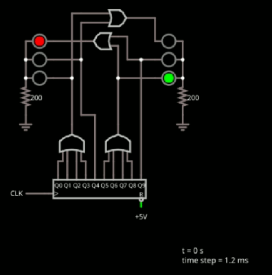

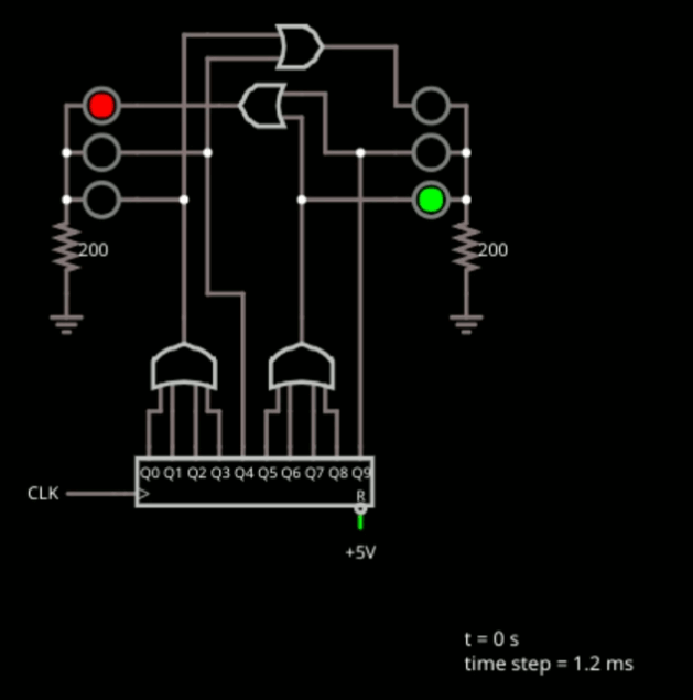

When do you need an FPGA? A classic classroom exercise for an FPGA, for example, is a traffic light because it shows off how to do state machines, which are important for some kinds of FPGA designs. But other than as a learning example, why would you do this? Even a simple 8-bit CPU can handle a traffic light.

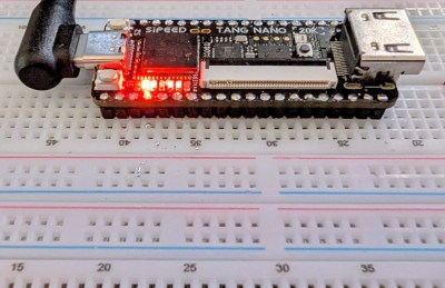

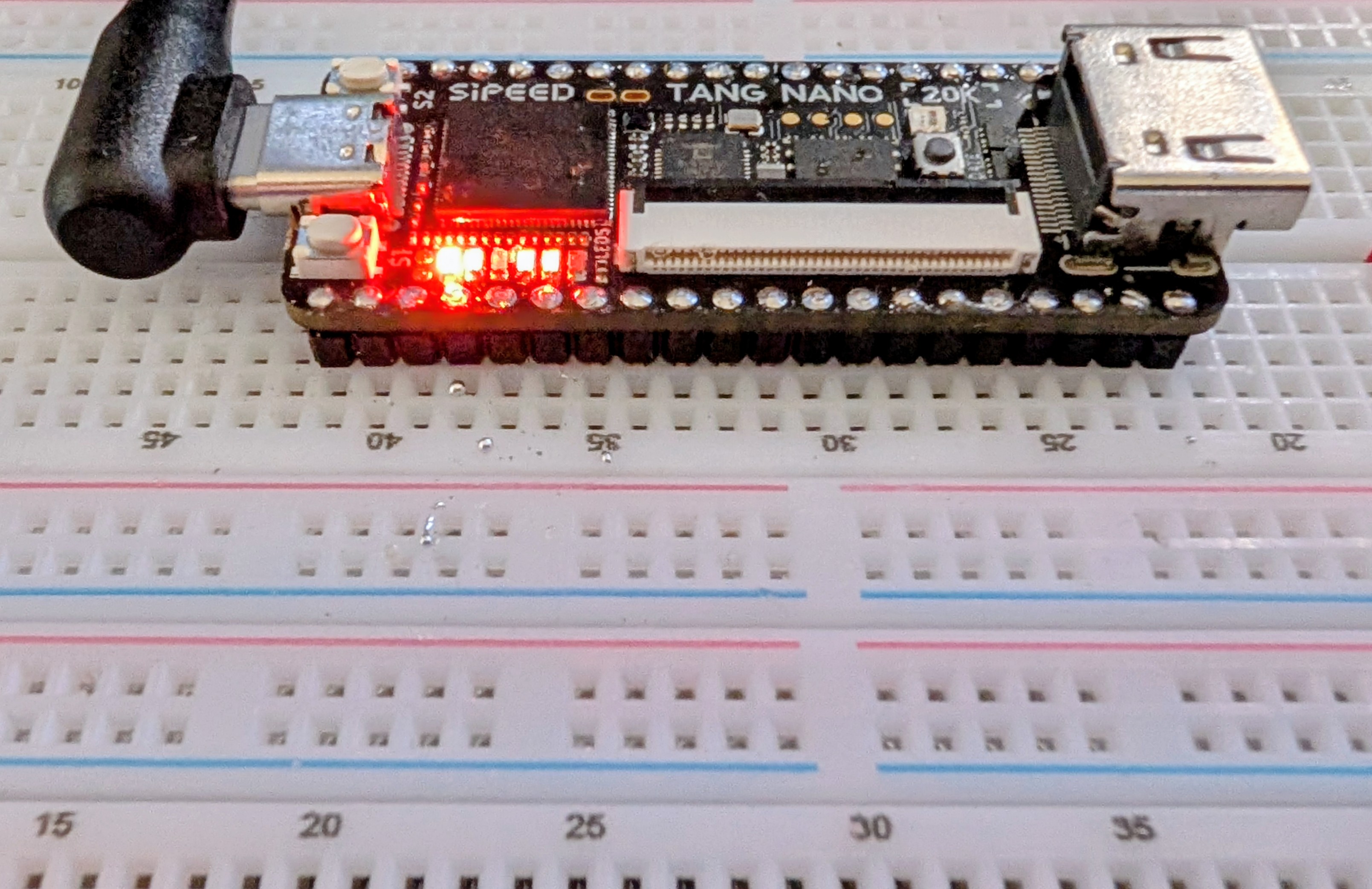

How big of an FPGA do you need? It is hard to compare FPGAs because the blocks are different. Think of PC memory. You can talk about 1 GB vs 4 GB, but the full picture depends on the memory speed, bandwidth, and timing. FPGAs are the same way. Two FPGAs may have a similar number of building blocks, but one may have much more powerful building blocks than the other. However, the 20K board’s FPGA is quite capable, even if it is hard to compare it directly to other FPGAs from other vendors.
It uses GOWIN’s GW2AR-LV18QN88C8/I7, which contains 20,736 four-input look-up tables (LUT4s) and 15,552 flip-flops. The exact maximum clock rate depends heavily on the logic and routing, so there is no single useful “FPGA clock speed,” but the device is quite comfortable in the low hundreds of MHz for appropriately pipelined designs.
Where the chip shines is memory. Most FPGAs have distributed RAM, which eats up resources on the chip, and block RAM, which are dedicated RAM cells. The GOWIN has both of these options. It also has a separate 8 Mbyte, 32-bit SDR SDRAM right in the package. Of course, you have to eat up some FPGA resources to talk to it, but not as much as you might think, and certainly not as much as it would take to place an 8 Mbyte RAM in the FPGA fabric.
There are other special-purpose blocks, like 48 18×18 multipliers, you can configure in a few ways. The Nano 20K board also has a programmable clock generator, QSPI flash (64 Mbits), and connections for audio, LCD, microSD, and HDMI. A microcontroller lets you program the clock generator, flash the chip via JTAG, or provide a virtual serial port back to the host.
