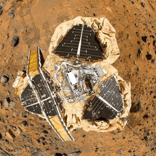

You’ve probably heard of Mars Pathfinder, the NASA lander and its Sojourner rover that took up residence on Mars in 1997. At first, all was well, but after a few days, the lander suffered a series of total system resets. A watchdog timer detected a problem and forced reboots. [Vivek Bhageria’s] recent post looks into what happened and the eventual solution.
The root cause was priority inversion. This happens when a lower-priority task holds a resource needed by a higher-priority task and prevents the higher-priority task from executing. In this case, the operating system was VxWorks, but this can happen on any kind of priority scheduling system.
The simplified version is that there were two tasks that each used the same mutex to avoid stepping on each other. The highest priority was a data distribution task. The lowest priority task dealt with meteorology data processing. There was also a medium-priority task that handled bus maintenance.
The failure would occur when the low-priority task had the mutex and lost its time slot before releasing it. The high-priority task would then find it couldn’t take the mutex. However, the low-priority task didn’t get control again because of the medium-priority tasks waiting to run.
In effect, the high-priority task was now waiting on something that couldn’t become available until the lowest-priority task was able to run. That’s priority inversion.
Sadly, engineers noticed this happening occasionally during testing but, as we are often prone to do, they chalked it up to glitches. As one of our old bosses used to say: “If you don’t know why it happened, then you don’t know that it won’t happen again.”
VxWorks, of course, understands that this might happen and, luckily, there was enough capability on the spacecraft to turn priority inheritance on for the mutex in question. This allows the low-priority task to get a boost because a higher-priority task is waiting on it.
You can read more about the details in the post. We also covered this a decade ago with our own analysis.

Its quite easy to to enable priority inversion in vxworks, but it is not on by default, it is an option when you create the mutex. Even that only protects against two task competing, you can get the situation of 3. The important thing is to define your taks so that they both don’t try and access the same resource at the same time, such as uses messaging etc

And they did fix it, and it lasted 76 sols beyond its 7 day planned mission.

They didn’t. They saved tax dollars doing this. The #1 absolutely most important do not break must work thing for missions like this is 1. comms with earth and 2. science/operations updates.
Those worked. They worked on the ground, they worked in transit, they worked on Mars. They were confident the mission-critical parts would work. Which they did.
The issue that they ran into was diagnosable and fixable on Mars (they have engineering models which stay on Earth for this reason). And it was diagnosed. And fixed.
Fixing minor issues on Mars is actually cheaper in most instances, because the staffing for the project has already stepped down to much lower levels – and holding up a small number of people for a time is cheaper than a large number of people.
