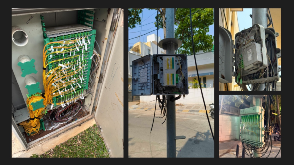

The hack centers around fiber-to-the-home connections, of which many deployments rely on Gigabit Passive Optical Network (GPON) standards. The key there is the “passive” part—these networks don’t rely on active components to switch signals. ISPs run central trunk lines out to optical line terminals (OLT), with passive splitters installed in neighborhoods to serve a number of downstream subscribers. Each subscriber then has something called an Optical Network Unit (ONU) in their home, which filters out the traffic intended for that specific subscriber.
Therein lies the flaw, though. Light (and thus, data) for many subscribers flows into the home, and it’s only the ONU that is filtering that out. Hack the ONU, or replace it… and you have access to downstream traffic from your neighbors that you shouldn’t be able to access.
The duo were able to hack an ONU to forward every single frame it receives, revealing downstream data intended for other homes in their immediate neighborhood. A great deal of traffic is encrypted these days, which provides a layer of safety, but it is by no means an ideal situation that such a hack is possible at all. They also explored other threats, such as installing splitters in publicly-accessible infrastructure, and compromising an upstream OLT and using it to flash firmware to other subscriber’s ONUs on the network. All this was presented in a talk at DEF CON, too, which can be viewed online.
