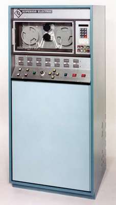

  4. About eight months ago my FIRST robotics team aquired a a 1960s bridgeport NC mill. Both the mill and the controller were in excellent condition, considering that we found them in a junkyard. The problem, of course, was that the mill controller looked something like this (http://www.wimb.net/sec_slosyn/img13/01mnc.jpg) and ran on punch tape. Not having an idea where to start, we started to call slo-syn (the maker of the controller) and bridgeport (the maker of the mill itself) asking for the syntax for running the mill over punch tape. We more or less got laughed at by everyone. Finally, as a last ditch efford, we emailed the webmaster of http://www.wimb.net. He promtly emailed us back with a full PDF copy of the mills originally manual. With this information in hand, we have designed and built a replacement controller for the mill that is roughly the size of a desktop computer. It is basically a bunch of relays that can communicate with a computer over USB which emulate the punch tape moving through the reader, and a microcontroller which emulates the logic of the original controller. We are currently in the process of writing a piece of software to parse gcode into the binary to which emulates the punch tape.
    Why do I tell you this story? A few reasons. One, if you want a low cost CNC solution, ressurecting an old machine may be a good idea if you have some time. Our project has cost our team a little over 1000 dollars, most of it going to initial mill purchase. The project could be made much cheaper with a smaller mill. Secondly, if you are trying to do this, the guy who runs http://www.wimb.net is a great resource, use him. Third, when we eventually reach some sort of finished state, expect a much better writeup submitted here.
