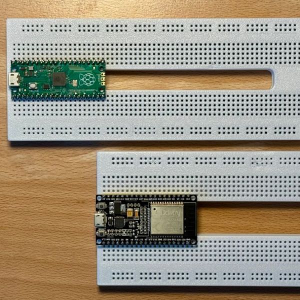

Although off-the-shelf breadboards are plentiful and cheap, they almost always seem to use the same basic design. Although you can clumsily reassemble most of them by removing the voltage rail section and merging a few boards together, wouldn’t it be nice if you had a breadboard that you could stick e.g. one of those wide ESP32 development boards onto and still have plenty of holes to poke wires and component leads into? Cue [Ludwin]’s 3D printable breadboard design that adds a big hole where otherwise wasted contact holes would be.
The related Instructables article provides a visual overview of the rationale and the assembly process. Obviously only the plastic shell of the breadboard is printed, after which the standard metal contacts are inserted. These contacts can be ‘borrowed’ from commercial boards, or you can buy the contacts separately.
For the design files there is a GitHub repository, with breadboard designs that target the ESP32, Raspberry Pi Pico, and the Arduino Nano. An overview of the currently available board designs is found on the Hackaday.io project page, with the top image showing many of them. In addition to the single big space design there are also a few variations that seek to accommodate just about any component and usage, making it rather versatile.

    1. I’ve always sawed them in half, stuck an dev board into them, and peeled the adhesive & stuck them onto a bit of plastic or plywood. Takes a minute or two. Less if you have a bandsaw.
  1. There are breadboards on ali where you can detach each power rail, so I do this:
    Buy 2 breadboards, detach only 1 power rail per board, mount the MCU devkit in the free space of board A and B where the power rails were stripped.
    It’s flimsy but works universally for any size of a board, and it is the only solution for a 3D-printerless serf like myself.

  5. I found a file somewhere for a breadboard tray that spaces two breadboards apart at the distance necessary for those wide boards. The breadboards are kept intact and can still be used as they were originally intended.
