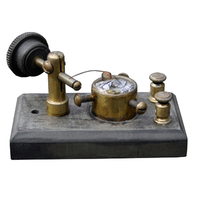

  27. Not sure why exactly but the title of this page: http://www.computerhistory.org/semiconductor/timeline/1901-semiconductor.html refers to lead-sulfide as…
    1901 – Semiconductor Rectifiers Patented as Ć¢Ā€ĀœCat’s WhiskerĆ¢Ā€Ā Detectors.
    I wonder if the original reference here was “Cat’s Whiskers” now known today more specifically as “Tin Whiskers”?
    The reference to WHISKERS – LEAD SULFIDE – ELECTRONICS etc. draws me to the conclusive opinion.
    1. It must be tough to reach Google from where you are. “Cat’s whisker” has nothing at all to do with tin whiskers. Why would it? You are talking about lead-sulfide.
      “Cat’s Whisker” refers to a thin wire used to make a non-linear contact with a bit of lead-galena crystal, to use as a detector in a radio.
      http://www.historywebsite.co.uk/Museum/Engineering/Electronics/history/catswhisker.jpg
      In fact, the very article you linked to has a good illustration of this:
      http://www.computerhistory.org/semiconductor/assets/img/400×400/1901_1_3.jpg
