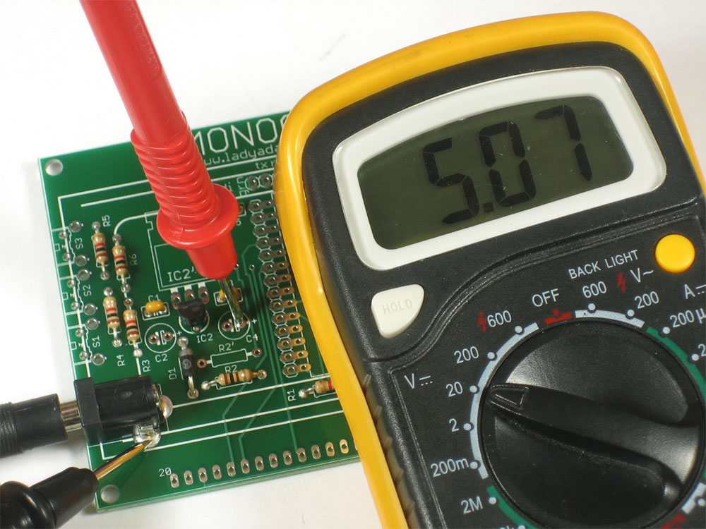

    any way – get comfy, grab a snack – here’s some feedback on your feedback. i’d like to again encourage you to post in the adafruit forums, but if you prefer here, that is fine. no one is really going to read all of this but you, so we hope you check back here.
    your comments in = =
    =neither the atmega nor rtc have decoupling capacitors=
    there are sufficient caps on the power supply. the whole thing draws -maybe- 50ma
    =the psu could have incorporated a bridge rectifier=
    *it does*. there’s a half wave d1 which protects from plugging in a negative/ac supply (although if you buy the kit it comes with a 110/220v switching power supply)
    =keep the power traces low-impedance;=
    *they are*. there’s a 9″ square ground plane on the back. the vcc lines are 24/16 mil. that’s already way overkill for something that draws 50ma.
    =one extra resistor would prevent possible problems if someone populates both ic2 positions;=
    the kit comes with only one regulator (the smaller one). and the documentation is clear how to install it. we originally weren’t sure which we’d ship with which is why there are two spots.
    =acid traps.=
    really? for a thm kit? do you have any strong justification that this is a real problem? our manufacturer passed this thru dfm with no complaint.
    =throw in a spare to92 voltage regulator on there somewhere for h4x0rz who might want an easy source of 3v3;=
    there’s a proto area. put it there if you want it. if there was another spot for a to92 regulator it could be confusing to beginners. and no paying customers has ever come up with a really good reason for requiring 3.3v
    =donuts… why? rows of paired pads would be 100 times more user-friendly;=
    we like perfboard-style. you don’t. *this is just opinion*.
    =extra 5v test points / solder pads? no ground test points / solder pads?=
    *there are multiple 5v/ground points available* on the atmega/ftdi/lcd breakouts but so far thousands have built it and done our 5v test with success
    http://www.ladyada.net/images/monochron/5vtest.jpg

    “there are sufficient caps on the power supply” is mostly inarguable. That the design as presented draws maybe 50mA is also inarguable. That putting decoupling capacitors on every microcontroller is common-sense, Electronics 101, professional-best-practice is also, except to you, inarguable.
    The discussion was about amateurism, remember? And you wanted specific examples, remember? I contend that leaving $0.02 worth of decoupling caps off an $80 kit is an amateur move.
    “there’s a half wave d1 which protects from plugging in a negative/ac supply” is kind of laughable. When that cheapo wallwart dies, or someone down the road plugs in an AC adapter by mistake, that half-wave rectifier is going to produce a crazy amount of ripple on both power and ground, despite ye olde 78L05. Yes, it *works*, I’m not arguing that. I’m arguing that it’s not particularly professional-especially since y’all left off the decoupling caps, which are (supposed to be!) there to deal with power noise.
    “the kit comes with only one regulator (and the instructions are clear on how to install it)” misses the point. If someone else makes copies of the board (open source, remember?), or does a shit job of translating the instructions into another language, or otherwise just has an Homer Simpson moment and populates both positions because they’re there, two resistors would avoid potential instability.
    “there’s a 9″ square ground plane on the back. the vcc lines are 24/16 mil. that’s already way overkill for something that draws 50ma.” Your power traces can *never* be too thick. Why use 24mil when 40mil will fit?
    “do you have any strong justification that [the presence of acid traps] is a real problem?” Define “a real problem”. As you should know, acid traps are not a sign of competent, caring, professional PCB layout. It’s introduction-to-PCB-design stuff.
    *Remember*, this started when someone called AdaFruit designs amateur. “But it works!” is not a terrific response to complaints that you’ve made less-than-professional design choices.
    “so far thousands have built it and done our 5v test with success” is inarguable. It would have cost NOTHING to add a couple of test points/solder pads to make hardware hacking easier. 2.54mm headers, or soldering wires to the legs of components? Which of these is preferable?
    “why? the lithium 3v rtc battery should last 7+ years and that’s assuming its running off the battery which is probably pretty rare for a desk/bedside clock. connecting it to an adc pin would just drain the battery faster.” Um, hacker-friendliness? That thing you like to brag about when it suits you to? Hell, *user*-friendliness? Since there’s already an RTC there, and the clock reads the date and time, it wouldn’t be too hard to code it to poll the ADC, say… once a day… to check the battery voltage, and leave that pin floating the remaining 23:59:59 of the day. That might, oh no, drain the battery prematurely, yes – BUT at least people would know the battery needed replacing. This isn’t a $5 K-Mart clock, pt. It’s $80. Making even a half-hearted effort to add a couple of features – even if they’re only optional – that would add NOTHING to the cost of manufacture – shouldn’t be too much to ask.
    “it just doesn’t make much sense [to do anything with the RTC square-wave output]”. It’s *there*, you could write neat code to utilize it and impress people with your skills. Hell, you *could* have been really just ridiculously awesomely nerdy and used it to drive the piezo buzzer, instead of using a precious ATMega pin. But, like you said, that does’t make any sense, does it?
    (I never said *all* your arguments were invalid. :) )

    =“there are sufficient caps on the power supply” is mostly inarguable. That the design as presented draws maybe 50mA is also inarguable. That putting decoupling capacitors on every microcontroller is common-sense, Electronics 101, professional-best-practice is also, except to you, inarguable. The discussion was about amateurism, remember? And you wanted specific examples, remember? I contend that leaving $0.02 worth of decoupling caps off an $80 kit is an amateur move.=
    wow, you’re still ignoring not only my previous comments but the schematics and the actual clock (you don’t seem to have one so it makes sense why you’re wrong about many things).
    **there is** there’s a 0.1uF decoupling cap right up against the microcontroller. as you can tell we specifically layed out the PCB so that the decouplers would be as close as possible to the microcontroller. read this x 2 ! repeat!
    =“there’s a half wave d1 which protects from plugging in a negative/ac supply” is kind of laughable. When that cheapo wallwart dies, or someone down the road plugs in an AC adapter by mistake, that half-wave rectifier is going to produce a crazy amount of ripple on both power and ground, despite ye olde 78L05. Yes, it *works*, I’m not arguing that. I’m arguing that it’s not particularly professional-especially since y’all left off the decoupling caps, which are (supposed to be!) there to deal with power noise.=
    that’s a good question! as you are well aware, a full wave also has ripple. so the question is, with a 10uF capacitor input, 60 db of ripple rejection at the 7805 and a 100uF capacitor output on 50mA draw will you see any of that on the output? well, if you’re really interested, i suggest doing the math and letting us know what the mV/% ripple is and if its more than say 5%. i am not going to do this math for you, this is your homework, you’ll see we are correct! i will bet you $50 in the adafruit store we are :)
    =“the kit comes with only one regulator (and the instructions are clear on how to install it)” misses the point. If someone else makes copies of the board (open source, remember?), or does a shit job of translating the instructions into another language, or otherwise just has an Homer Simpson moment and populates both positions because they’re there, two resistors would avoid potential instability.=
    that’s why we have photos for every component placement – so non-english speakers don’t have an issue. we can’t predict what non-customers DIY kit makers will do. they could stick a PN2222 in there. then what? that’s why we labeled one IC2 and IC2′ which is standard practice where we come from to indicate two optional component placements. if you’re dead set on this being the best suggestion ever, draw up how you -think- it should be and we’ll take a look! i know you won’t but consider it a challenge!
    =“there’s a 9″ square ground plane on the back. the vcc lines are 24/16 mil. that’s already way overkill for something that draws 50ma.” Your power traces can *never* be too thick. Why use 24mil when 40mil will fit?
    why not have a power plane instead of traces at all? because there’s no reason *to* do it if what is on the PCB does not require it. *you have a preference for thick traces* and we do too when it makes sense. here, it clearly does not make any difference so its *just opinion*.
    thicker traces, by the way, do affect kit soldering. at some point they dissipate too much heat so yeah you could neck them but we prefer to just max them out at 24mil when the current passed is 50mA. don’t you see now?
    “do you have any strong justification that [the presence of acid traps] is a real problem?” Define “a real problem”. As you should know, acid traps are not a sign of competent, caring, professional PCB layout. It’s introduction-to-PCB-design stuff.=
    we also sometimes use 90 bends! but yes, you should define a *real problem* – our PCB house does DFM, they tell us when there’s a problem. they passed it. tt goes to fab, they pass test without any problem. so again, now you know – what’s the problem?
    =*Remember*, this started when someone called AdaFruit designs amateur. “But it works!” is not a terrific response to complaints that you’ve made less-than-professional design choices.=
    again, you’re ignoring my detailed comments on your criticisms. it’s about design choices. if you’re so sure you could make it better, why don’t you? fork it on github and show everyone. scott did for one of our products. surely you could do the same right?
    that would end all of this and you’d show how to do it like a pro?
    =“so far thousands have built it and done our 5v test with success” is inarguable. It would have cost NOTHING to add a couple of test points/solder pads to make hardware hacking easier. 2.54mm headers, or soldering wires to the legs of components? Which of these is preferable?=
    that’s right, there are 2.54mm headers broken out from the atmega, we spaced them out so that people can easily wire to any of the pins. see how this all makes sense now that you know why?
    =“why? the lithium 3v rtc battery should last 7+ years and that’s assuming its running off the battery which is probably pretty rare for a desk/bedside clock. connecting it to an adc pin would just drain the battery faster.” Um, hacker-friendliness? That thing you like to brag about when it suits you to? Hell, *user*-friendliness? Since there’s already an RTC there, and the clock reads the date and time, it wouldn’t be too hard to code it to poll the ADC, say… once a day… to check the battery voltage, and leave that pin floating the remaining 23:59:59 of the day. That might, oh no, drain the battery prematurely, yes – BUT at least people would know the battery needed replacing. This isn’t a $5 K-Mart clock, pt. It’s $80. Making even a half-hearted effort to add a couple of features – even if they’re only optional – that would add NOTHING to the cost of manufacture – shouldn’t be too much to ask.=
    interesting suggestion and one you seem to care deeply about. nobody ever brought it up and we didn’t think it was terribly desirable so we didn’t break it out. luckily the PCB files are up so if someone like you who cares deeply about having a breakout pin for the battery they can add it. right now, we’re not sure its worth a board respin but if we do do one, we’ll consider breaking out the battery. till then, you can just solder a wire to the battery holder (its big and easy to solder to). thanks, we’re going to consider this one!
    =“it just doesn’t make much sense [to do anything with the RTC square-wave output]“. It’s *there*, you could write neat code to utilize it and impress people with your skills. Hell, you *could* have been really just ridiculously awesomely nerdy and used it to drive the piezo buzzer, instead of using a precious ATMega pin. But, like you said, that does’t make any sense, does it?=
    *BINGO AGAIN* see, now you’re talking. that’s a GOOD IDEA! that’s a way to save a pin on the atmega!
    that’s 2!
    =(I never said *all* your arguments were invalid. :) )=
