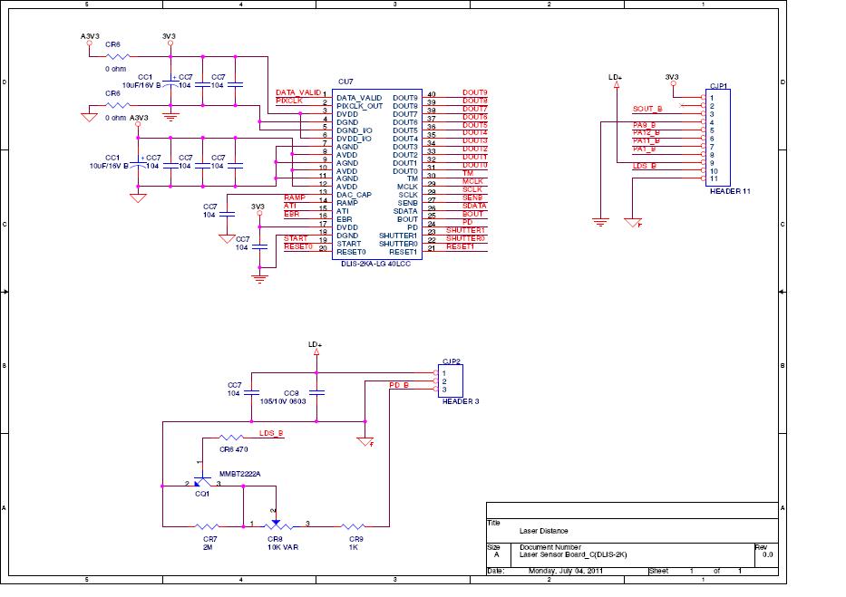

The LIDAR module is made of two big chunks; the laser and optic assembly, and the sensor board seen above. [Hash] put it under the microscope for a better look at the line scan imager. The magnification helped him find the company name on the die, this particular part is manufactured by Panavision. He figured out the actual model by counting the bonding wires and pixels in between them to get a pretty good guess at the resolution. He’s pretty sure it’s a DLIS-2K and links to an app note and the datasheet in his post. The chip to the right of the sensor is a TI digital signal processor.

here’s a simple schematic to get started with the DLIS-2K: http://3.bp.blogspot.com/-_wPU-AuG4hg/TkePrsMfKeI/AAAAAAAABJw/tbdE0clcTBs/s1600/Laser+Distance_2.JPG
