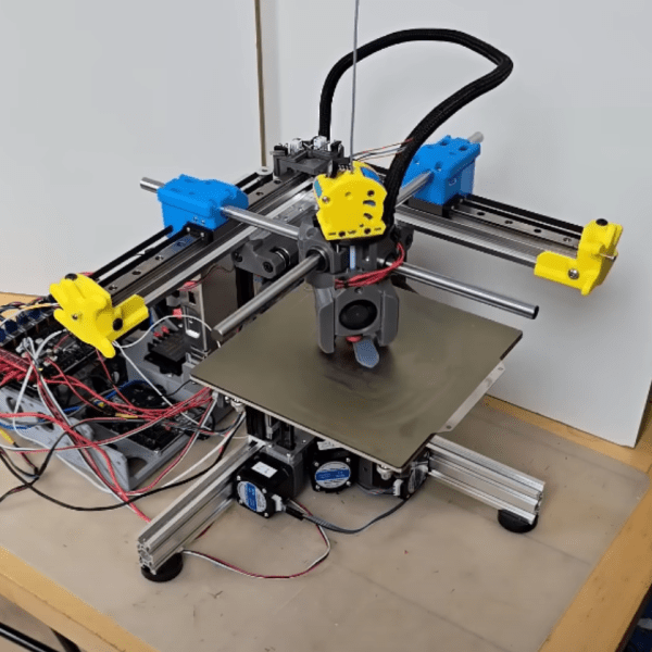

A 3D printer is in the process of printing a test piece. The printer has two horizontal linear rails at right angles to each other, with cylindrical metal rods mounted horizontally on the rails, so that the rods cross over the print bed. The print head slides along these rods.
If you’re looking for a more open, unenclosed 3D printer design than a cubic frame can accommodate, but don’t want to use a bed-slinger, you don’t have many options. [Boothy Builds] recently found himself in this situation, so he designed the Hi5, a printer that holds its hotend between two cantilevered arms.
The hotend uses bearings to slide along the metal arms, which themselves run along linear rails. The most difficult part of the design was creating the coupling between the guides that slides along the arms. It had to be rigid enough to position the hotend accurately and repeatably, but also flexible enough avoid binding. The current design uses springs to tension the bearings, though [Boothy Builds] eventually intends to find a more elegant solution. Three independent rails support the print bed, which lets the printer make small alterations to the bed’s tilt, automatically tramming it. Earlier iterations used CNC-milled bed supports, but [Boothy Builds] found that 3D printed plastic supports did a better job of damping out vibrations.
[Boothy Builds] notes that the current design puts the X and Y belts under considerable load, which sometimes causes them to slip, leading to occasional layer shifts and noise in the print. He acknowledges that the design still has room for improvement, but the design seems quite promising to us.

    I agree, it looks less cluttered and light, but is it really? I’m not sure if anything is saved in parts or size compared to a core-x-y, maybe a shorter belt and two rollers?
    But I would expect that printing on the far end comes with lower accuracy and more artifacts due to stability. Non uniformity across the print bed is an annoying limitation.

    1. A bit, but not the same. And I think a critical difference is that the belts here cause the sliders on the linear reals to be pulled skew, causing needless extra friction. Putting the belt above/below the rail would help here.
      I think those are also NEMA14 motors, we use NEMA17 at Ultimaker, as just putting some more power behind that is worth it for reliability.
