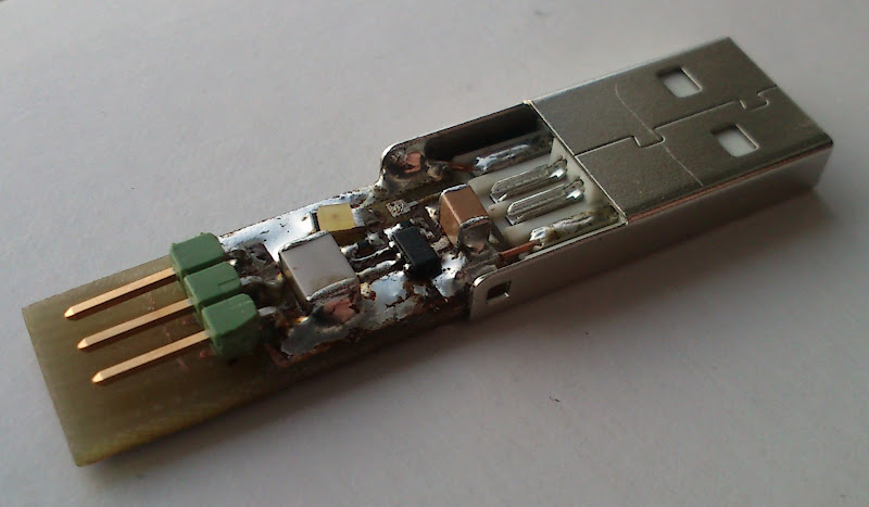

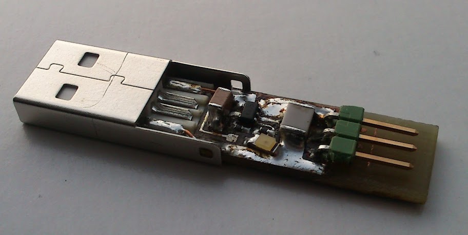

In the original design of [Paul]’s board, he chose a Maxim MAX1551 Lithium battery charger. Confounded by the expense and/or unavailability of this IC (although Sparkfun has a few), he moved onto the similar Microchip MCP7813. This IC supports charging from a power source from 3.5 to 6 Volts as would be found in a USB hub.
The board [Paul] came up with is incredibly small – just barely larger than the USB plug itself. The layout is fairly simple as well. We’re thinking this could be a highly useful application of some home board fabrication. If you have a simpler way to charge LiPos that don’t require a specialized chip, send it into the tip line.

Improvements over this?
http://www.sparkfun.com/products/10161
Cheaper, smaller, made it myself so I can include it in future circuits. More flexible options with Microchip’s selection of chips : http://www.microchip.com/ParamChartSearch/chart.aspx?branchID=9011&mid=11&pageId=79
They have chips that can charge more than one cell at a time. Not doable with that Sparkfun charger.
Its sexy! I have made a ton smaller than this tho. But i used a Mini B USB Connector. What i would recommend to save MONEY and PARTS is to create the actual USB TYPE A Part on BOARD… like with traces… That looks like a Gold plated PCB as is so it would have been ok.
For the heck of it, I went ahead and tried to do as you said–lay out a PCB that includes the USB plug (not as a separate component, but as part of the PCB, like the USB business card), and not only was I able to get a smaller overall footprint, I was able to do it on a single layer, with no vias. Overall dimensions: 0.875″ x 0.55″, including the USB plug (0.475″). Replace the plug OP used with a 2-pin right-angle pin header, and it goes down to about 0.75″ length.

I would think you could get away with leaving the USB connector component off and designing traces into the board that woudl mimick the connection points of the usb port. With the right thickness of board this can make a pretty solid connection.
You can build a Lipo charger with a low end microcontroller if you want to. You do need an ADC to check the voltage, but something like an ATTiny13 would be fine.
The Lipo charging curve has three stages: preconditioning, constant current, and constant voltage. All are based on a current value called ‘C’, the mA/hr rating of the battery in question, and a voltage called ‘Vreg’, the battery’s nominal voltage.
Preconditioning supplies current at .1C while the voltage across the terminals is less than 2/3 Vreg. For most Lipos, that’s about 2.8v.
Once the voltage across the terminals reaches 2/3 Vreg, the circuit moves to constant current mode. It supplies current until the voltage across the terminals reaches Vreg. The amount of current varies with the design, ranging from .2C to 1C. Higher currents charge faster, lower currents charge better. You never want to go higher than 1C though.
Once the voltage hits Vreg, the circuit moves to constant voltage mode. It reduces the current to keep the terminal voltage at Vreg until the current falls to between .03C and .07C.

The reasons to use a dedicated chip are the usual ones: cost, size, and simplicity. The MCP3811 costs about 50c if you buy a single one, 39c in lots of 100. The ATTiny13 costs 75c per unit, @66c per 100. The MCP3811 comes in an SOT323 package (about as big as a grain of rice) and the ATTiny13 comes in SOT8 (about a quarter inch square). You can just drop the MCP3811 into a circuit and let ir run, where an ATTiny13 needs programming and additional components to control the current/voltage.
OTOH, hardware hackers aren’t limited by the same rules that drive commercial designs, and are more likely to have a uC like the ATTiny13 in stock than a specialized chip like the MCP8311.

The chip OP used actually implements most of the features you mention–precharge, constant-current, constant-voltage, and this one even has an LED indicator for charge status. Sure it won’t do under-voltage protection or over-current protection (when the battery is in use), but a simple charger, it’s great. With the PCB, you’re looking at <$2 apiece if you get a batch of boards from iTead Studio or seeed Studio.

NEat hack and all, but the reason makes no sense. A search on Octopart.com shows at least a thousand of them available from 6 merchants. And no price more than $2.50. Compared to the price of your project catching fire, that’s cheap.
“I thought it would be neat to…” is a perfectly acceptable excuse for a hack. One of the best in fact.

A device also worth considering is the MCP73831 which supports automatic re charge. could be useful in applications where the battery needs to be used as it is charging. here is one I assembled to use on a breadboard: http://sunbizhosting.co.uk/~spiral/blog/wp-content/uploads/2012/01/Lipo-Charger-f-b.jpg

I get scared off of SMT boards that require reflow soldering. This board’s small, but SOT-23 so the pins aren’t THAT close together.
I’ll have to try out the Dorkbot PCB service – been meaning to do that anyhow – as I don’t trust my relatively recently-acquired home etching skills for something this small.
