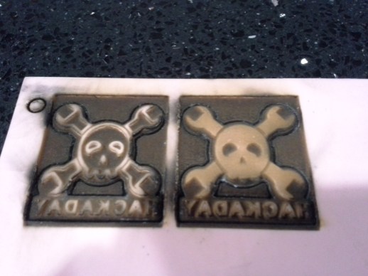

MAKING WITH A LASER CUTTER
We started with the Hackaday Logo SVG file and modified it in Inkscape. It was then opened in Corel Draw for sending to the Laser Cutter, which in this case was an Epilog. Lucky for us the Epilog print driver has a stamp feature. After opening up the SVG file, verify the stamp is the correct size. Then draw a rectangle around the stamp geometry and make the line type ‘hairline’. The software’s stamp feature will need this rectangle to bound the relieved (lasered) portion of the stamp. To turn on the stamp feature, in the Corel Draw print dialog box click on ‘print properties’ to get to the Epilog driver dialog box. Click the ‘advanced’ tab to show the stamp options. Checking ‘mirror’ will reverse the image so the image on the physical stamp is reversed but the ink stamping will come out in the correct orientation. The stamp feature also will put what Epilog calls shoulders around the artwork, stiffening thin areas of the physical stamp. We used 30% speed and 100% power and had to do 3 passes to get a deep enough cut.
shoulder
Physically, the lasered stamp rubber came out well but it also became burned. Even the non-lasered area became discolored from the fumes. Scrubbing with soap and water didn’t make any perceivable difference. This discoloration had no effect on the stamp’s performance.
We then moved on to the Hobby Foam which cut like butter. Typically that is a good thing but it also melted the foam and left a wide kerf, so wide in fact that the letters end up just being holes.

RESULTS
The stampings are in and they certainly exhibit a wide range of quality. Click on the photo to check them out in detail.
Passport Stamp Test Results
All of the rubber stamps came out very well, as you would expect since this material is made for ink stamping. They all look good, are very clear and the letters are easily readable. Both the Laser Cutter and CNC Router produced a very usable stamp with the stamp rubber.
The hobby foam transferred ink well but the laser melted away fine details, thin sections and all of the lettering. Plus, each of the 5 pieces had to be glued onto a backer plate individually which made it difficult to align the pieces correctly.
The wood and printed hard ABS are the worst at transferring ink even though the geometry came out well. The flexible PLA worked much better and would be a great option for hackerspaces that do not have access to a CNC Router or Laser Cutter.
