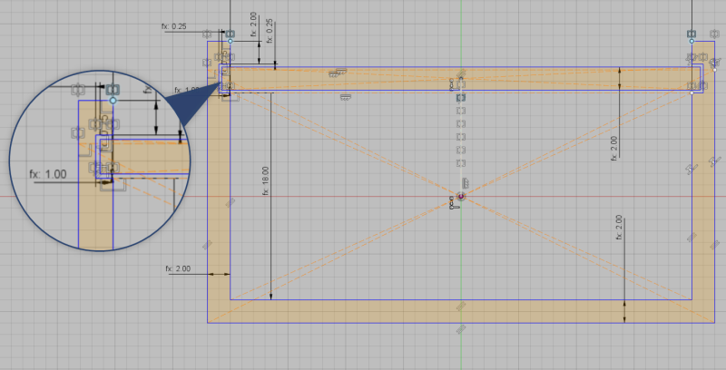

- Length – The length of the inside of the box. Since my box is for holding things I don’t care how big the outside is. I’d rather have the software calculate that.
- Width – The width of the inside of the box.
- Height – The height of the inside of the box.
Your best friend. Secretly math. - Thickness – How thick the walls and the lid are. I also derive the thickness of the ribs on top from this number.
- Fit – This is the fit/clearance between the lid and box. 0.25mm is pretty easy to hit for a well tuned printer.
Next came the sketch. When using any modern CAD software it’s important to keep in mind that what you are doing isn’t really drawing as much as it’s building a mathematical model of your object. I tend to think of the process as graphical programming. One mistake I see a lot of newbies make is to completely ignore the dimension tool (shortcut: D) and the constraints panel. The constraints tell the software that, mathematically, Line A is always parallel to Line B, or Circle A is always tangent to Line B. Grasping this lets you create models that will expand and adjust with changed dimensions and design considerations. It also dramatically speeds up your drafting time.
A few tips on the sketch:
- Fusion has some great hotkeys. Some of the ones I use are Q – Cut/Extrude (push/pull) the sketch, D – dimension, C – circle, L – line, and P – Project.
- Double check your constraints. Fusion is conservative about which constraints it places for you. Make sure the obvious ones are there.
- The parameters are case-sensitive. “Thickness,” is not the same as, “thickness.”
- I could sketch the box, and then using relations to the box, sketch the lid. However, if the shapes in the sketch aren’t touching they will be extruded as separate bodies.

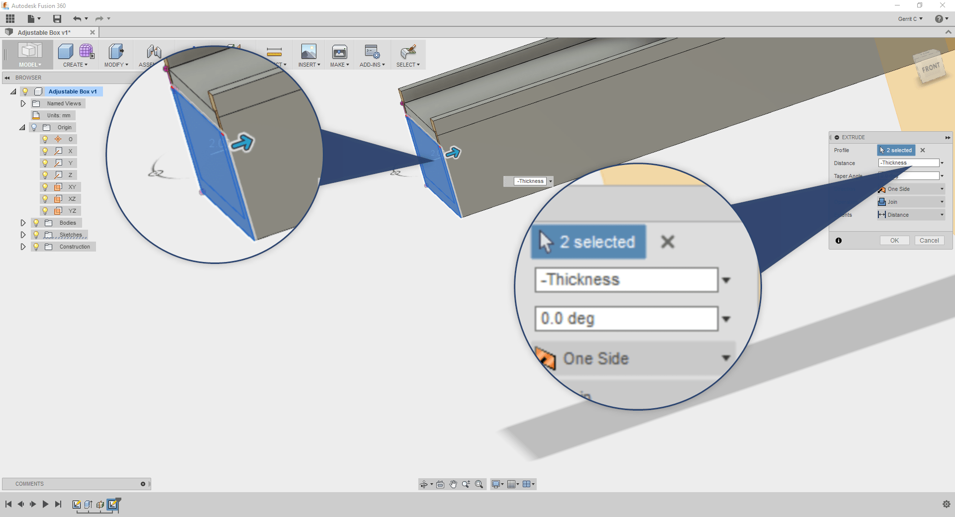

Once the profile of the part was finished I selected the lid profile and the box profile and extruded the box. Again, since I want a parametric part at the end, rather than entering numbers during this step I enter in the variables I had set previously.
Right now the box is a lid and an extrusion without ends. I need to cap the ends of the box. To do this, I will use a plane and the mirror operation to copy the ends to both sides. If that sentence is off, another way to think of this is pseudo code.

Now it’s time to test the file. We’ll go back and open the parameters window and change one of the dimensions. Oh no! An error. Like any code, it didn’t compile the first time. In this case, when I drew the initial slot I didn’t have the midpoint of the slot constrained to the middle of the lid. I drew a line from one end of the box to the other, making sure to constrain each of its ends to the middle of the lid, and then used the coincident constraint to attach the middle of the slot to that line. Creating a mathematical relationship.
After fixing the sketch, I tried again. It works! When I change any of the values I get a new model of the box. As you can see in the opening image of this post! I used the make command to generate STLs for my printer. Then, admittedly, went a little overboard on the tiny boxes.
