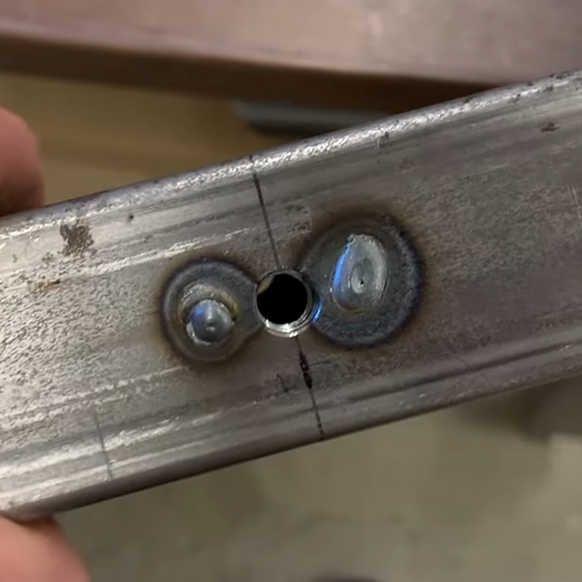

[Jer Schmidt] needed a way to put a lot of M8 bolts into a piece of square steel tubing, but just drilling and tapping threads into the thin steel wouldn’t be strong enough. So he figured out a way to reliably weld nuts to the inside of the tube, and his technique works even if the tube is long and the inside isn’t accessible.
Two smaller holes on either side. Weld through the holes. A little grinding results in a smooth top surface.
Essentially, one drills a hole for the bolt, plus two smaller holes on either side. Then one welds the nut to the tubing through those small holes, in a sort of plug weld. A little grinding is all it takes to smooth out the surface, and one is left with a strong threaded hole in a thin-walled tube, using little more than hardware store fasteners.
The technique doesn’t require access to the inside of the tube for the welding part, although getting the nut back there in the first place does require a simple helper tool the nut can slot into. [Jer] makes one with some scrap wood and a table saw, just to show it doesn’t need to be anything fancy.
Another way to put a threaded hole into thin material is to use a rivnut, or rivet nut (sometimes also used to put durable threads into 3D prints) but welding a plain old nut to the inside was far more aligned with what [Jer] needed, and doesn’t rely on any specialty parts or tools.
[Jer]’s upcoming project requires a lot of bolts all the way down long tubing, which is what got him into all of this. Watch it in action in the video below, because [Jer] has definitely worked out the kinks, and he steps through a lot of tips and tricks to make the process painless.

      1. Think it more depends on what you need – far as I know nobody makes a riv-nut with a tapered seat or a drill bit for them to create that step for a standard nut to have that flush finish to the surface seen here. The rivet part also means you need a fair bit of depth to get the crumple zone in, so a tube like this it could be too thin to allow you to put them in everywhere you want. Also have the mixed material question – you can use this concept with a variety of steel, Aluminium, some copper alloy as long as you can plug ‘weld’ it.

  7. The idea of adding wings to a nut that is then plug welded in place, nothing jaw dropping, but why wouldn’t you weld the wings on before sticking it in the tube. That way you aren’t welding through a hole.
    Personal I either just make my own square nuts out of some 1″ x 0.25″ flat bar, or just use a flange nut.
    Flat bar works best as I can make it big enough that I’m not cooking the threads when welding.
