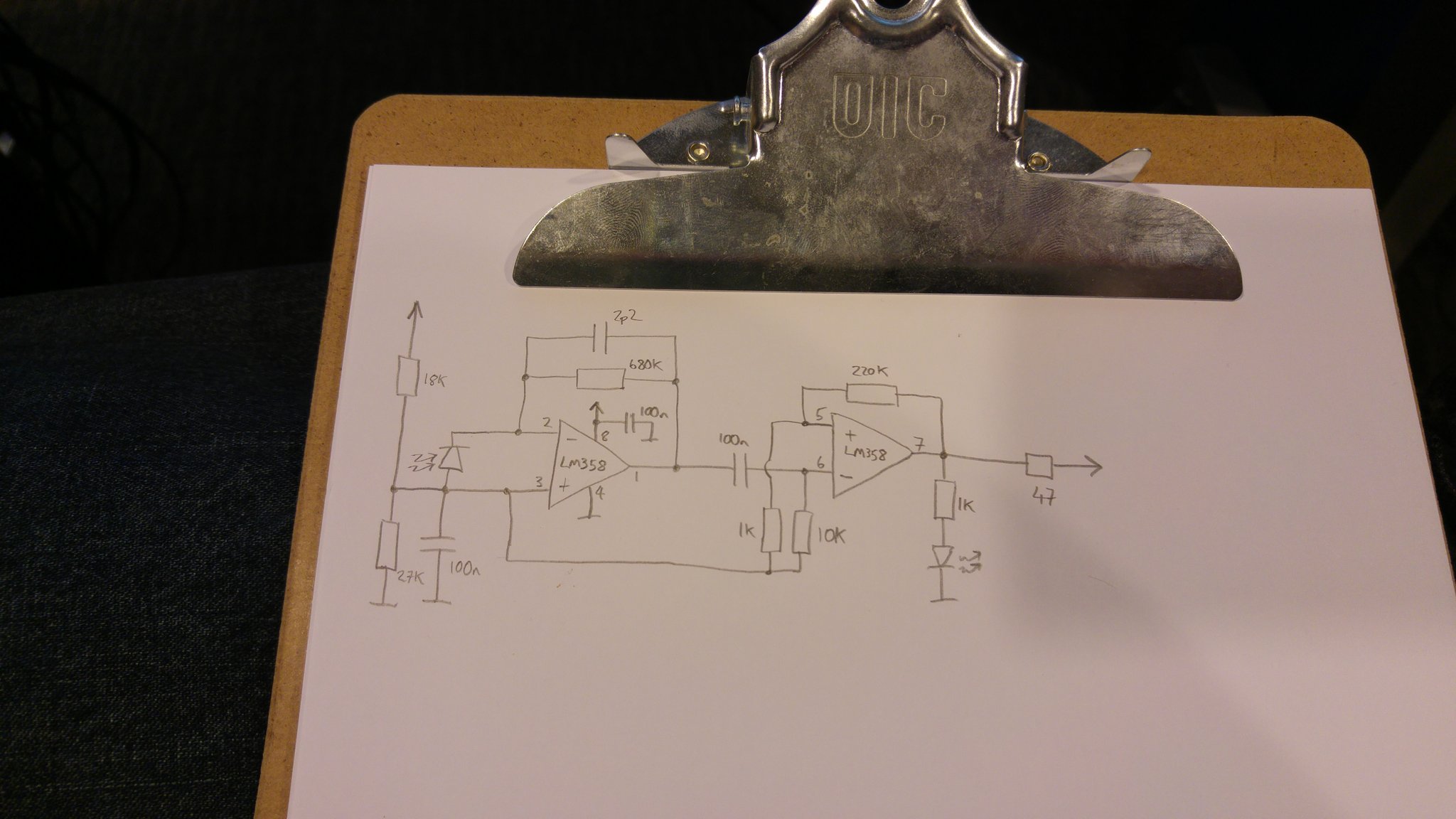

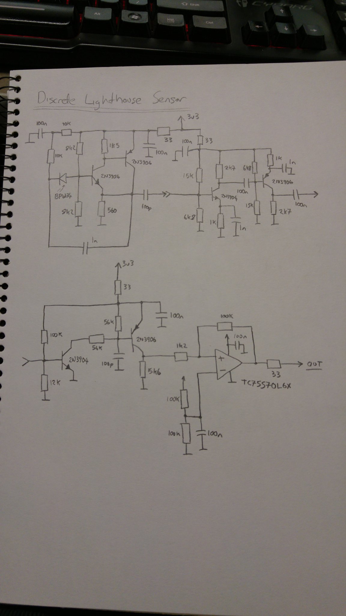

    Second, the sensor is known – the real Vive wands use BPW43 photodiodes. The most likely reason for a photodiode instead of phototransistor is that is that the laser light from the lighthouses is modulated at around 2 MHz or so, both for helping to eliminate interference from other light sources and to potentially to allow more systems to work in the same space by transmitting data over the light signal. Phototransistors may not be fast enough for this.
    The range problem the poster has is because he has connected the phototransistor directly to the MCU, with no amplification, signal filtering, nothing. So no wonder it performs very poorly and works only when very close to the LightHouse. The optical filter is not needed, because the phototransistor he is using has an IR pass one built-in (dark plastic casing is the filter).
    The actual hardware (or at least the older, less integrated versions of it) has been posted by Alan Yates from Valve and is a lot more complex, needing several transistors + comparator for each photodiode. Or one can use 2 opamps like they have done in one of the very early prototypes, but that is going to be bandwidth limited. The current retail version uses a custom ASIC to allow for miniaturization (and to reduce costs) instead.
    This is the opamp-based sensor amplifier:
    https://pbs.twimg.com/media/Cl2SiwJUYAAhd8l.jpg:large
    And this is the early discrete one:
    https://pbs.twimg.com/media/CfA7HtZVIAAtoRK.jpg:large
