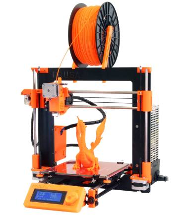

Taming Shaky Frames
The age of the shaky Mendel threaded rod frame is long over, it has been replaced by the age of shaky single-sheet Prusa i3 frames. Decent printing results require a darn sturdy frame, so add brackets and stabilizers wherever you can.
If you’re building a cube-style printer from aluminum extrusion, use angle brackets to stabilize the frame. If you’re building a Prusa i3 variant, make sure you’re either getting a frame with stabilizers or add stabilizers later. If you’re building a classic Mendel, add stabilizer boards to the cross struts.
Facing 3D printed parts
PLA is a horrible material choice for the 3D-printed portion of a DIY 3D printer, first for it’s low melting point, and second for its brittleness. Almost any material will perform better, but at least ABS parts can last forever. Print them really hot – at least 255 °C to get a good layer adhesion and they will never fail on you. Nevertheless: Always keep a set of spares, because you can. It needn’t be a 3-pack.
Yet, the absolute accuracy and surface quality of 3D printed parts isn’t generally as polished as the aluminum extrusion and sheet materials they attach to. When you attach a 3D printed part to a flat surface using screws, you have basically two options to get a solid connection: Make the screws very tight – which almost always breaks the 3D printed part – or use a fine grit sandpaper to flatten the contact surface of the 3D printed part to get a good contact between the two. Once the screws apply a reasonable amount of pressure, the static friction between the two surfaces takes over and provides a high resistance to shearing forces.
Drive systems
In conjunction with a rigid frame, both belt drives in various configurations (except for the H-bot) and spindle drives can achieve a repetitive accuracy that exceeds the requirements of FDM in the X and Y direction by magnitudes. However, the quality and longevity of any drive system depends a lot on the quality of the involved components. Eccentric pulleys or couplings, as well as components that introduce backlash, are the most common pitfalls here. Grinding belt teeth can cause vibrations, so make sure all belts are running in the center of their pulley and idler tracks. Use flanged idlers or at least washers to prevent the belts from rubbing against other parts of the printer.
For the Z-axis, it’s worth mentioning that the quality improvement you may expect from a stepper motor with integrated ACME lead screw shaft over the common threaded-rod-on-a-flex coupling solution is pretty insignificant – even in terms of longevity. Stainless steel M5 threaded rods in the Z-axis allow for great printing results and last for many years, even when exposed to the steady stress of auto bed leveling. In this case, the budget solution may be good enough. Of course, large and heavy printer assemblies do indeed require proper leadscrews.

Long heat up times are a productivity killer, and to reach the temperature fast – within 3 minutes or so, a regular PCB heated bed needs to have a power density of about 1+ W/cm2 (6.5 W/in2). To reach 110° (230 °F) under normal conditions at all, a heated bed should deliver a minimum power density of about 0.3 W/cm2 (2 W/in2). If you want to print materials like ABS, that require a high bed temperature, take the necessary wattage of the heated bed relative to its size into account.
Single sided PCB heated beds tend to breathe up and down, due to the non-uniform thermal expansion of the copper traces and the board material, which can result in a surface finish that is affected by banding patterns. The animation shows the issue quite clearly:
single_double
Single-sided PCB heated bed (left) / Double-sided PCB-heater (right)
Since high-quality prints rely on a Z-positioning accuracy in the tens of microns, even minor temperature fluctuations can cause a single sided PCB heater to introduce unwanted artifacts. Use double sided PCB heaters or other alternatives that don’t suffer from this issue (i.e. silicone heater mats attached to a solid slate of aluminum), along with a well-tuned PID control loop.
Modern heated beds, such as the Prusa MK42, achieve a more uniform temperature distribution by compensating non-uniform heat losses with a non-uniform power density, which helps a lot with making large structures stick to the build plate in its corners. In any case, always use a thermal cutoff fuse attached directly to the center of the bottom side of the heated bed.
heatbeds
Thermal image of legacy Prusa MK2B (left) and new Prusa MK42 (right) (by Josef Prusa, image source)
The heated bed must be mounted rock-solid to the frame or carriage it rests on. Don’t use loose adjustment screws with wobbly springs to mount them, as they will seriously affect the printing quality. Ideally, bolt the heated bed down as straight as possible and use auto bed leveling for the fine adjustment.
