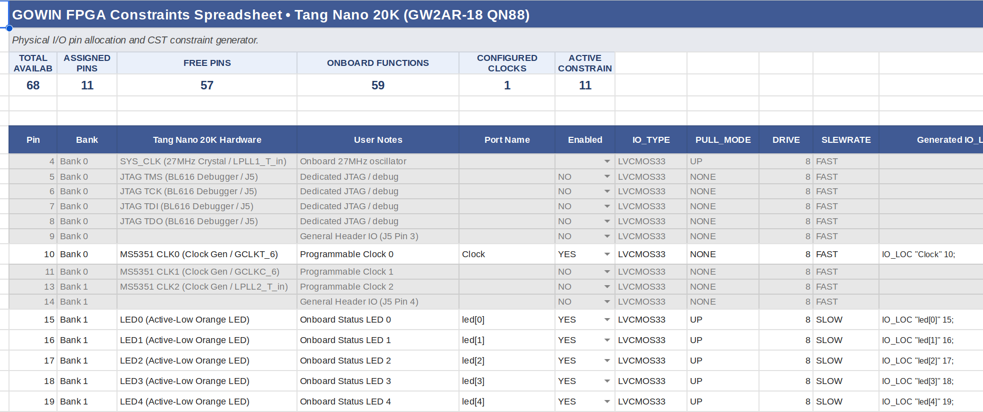

You also lose the nice GUI constraints editor: the thing that lets you define what pins correspond to what Verilog names. That’s a small problem, because you can just write your own constraint files as text. Or you can use this spreadsheet I built to make it a little easier, or visit GitHub for a lightly-tested Excel version. Just save your own copy and edit it. If you prefer using Visual Studio Code, try this constraint editor extension.

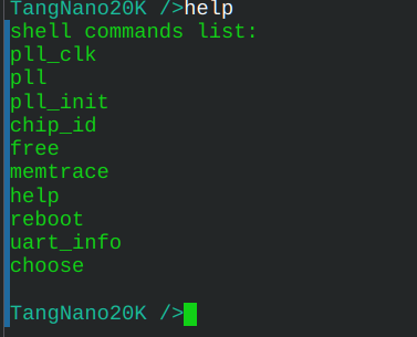

However, the serial port goes through a microcontroller, the same one that flashes the FPGA. It is always watching for a special input character sequence ^X^C [Enter]. That should give you a “TangNano20K />” prompt. If you suspect your version might be old, you can update it using Sipeed’s instructions. Make sure you pick the correct firmware from the table, as there are similar versions you can flash that look newer but are incompatible.
The board has a few clocks you can program. We will use O0, which is on FPGA pin 10. So once you are at the prompt, you can type:
pll_clk O0=27M -s
If you want to check the status, you can just use pll_clk with no arguments. We don’t use the UART at the moment, but if you did, “choose uart” would put it back in normal mode.

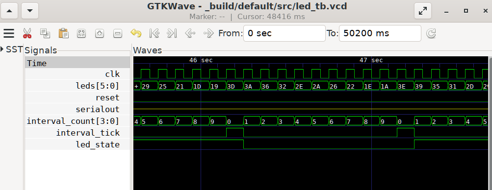

Here’s the basic idea: We create the top module of our design (led), but we wire it to run at 10 Hz with a 1-second interval. You could simulate at 27 MHz, but it would create huge files that are harder to work with. At the start of the simulation, we generate a clock change every 50 milliseconds, so the period is 100 milliseconds (10 Hz).
The last initial block also operates at the beginning. It first sets the variables we want to dump. If you look at other tutorials or you’ve done this before, you might wonder where $dumpfile is. APIO likes to set that itself. It also insists that you name the file something_tb.v (or _tb.sv if you are using SystemVerilog). You can change the something part, but it has to end with that pattern for APIO to pick it up.
Simulation output shows it all.
If you don’t include $dumpvars, you’ll get an empty simulation file. Then there’s a brief reset signal. Then we wait a long time (#50000 is 50 seconds here, but the simulator will run that much faster, so you won’t have to wait). Then there’s a call to $finish. Without that, the simulator will run forever.
Once you have this file in place, you can open the APIO verify and select “sim.” The result is a nice graphic view in GTKWave. You can add more signals from deeper down in the hierarchy.
