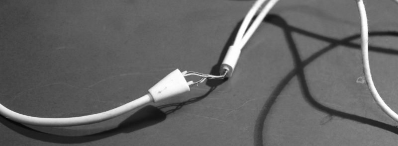

Cable Strain
Next comes cable strain. People like to complain about how the iPhone earbuds would constantly break at the joint. This is true, and other brands had better strain relief. However, it’s also true that all audio cables that go into a pocket will break before any of the other components will reach their end of service life.
A story as old as time, which incidently is about as old as the headphone jack.
It’s not the cord’s fault. It was sent to the frontlines without the right equipment.  [CC Paul Hussey]
By nature, a pocket exceeds every reasonable expectation of in-tolerance cable strain. It is a hostile environment. My last set of headphones went through two cables during regular use. Which segues right into the next design flaw, force.
