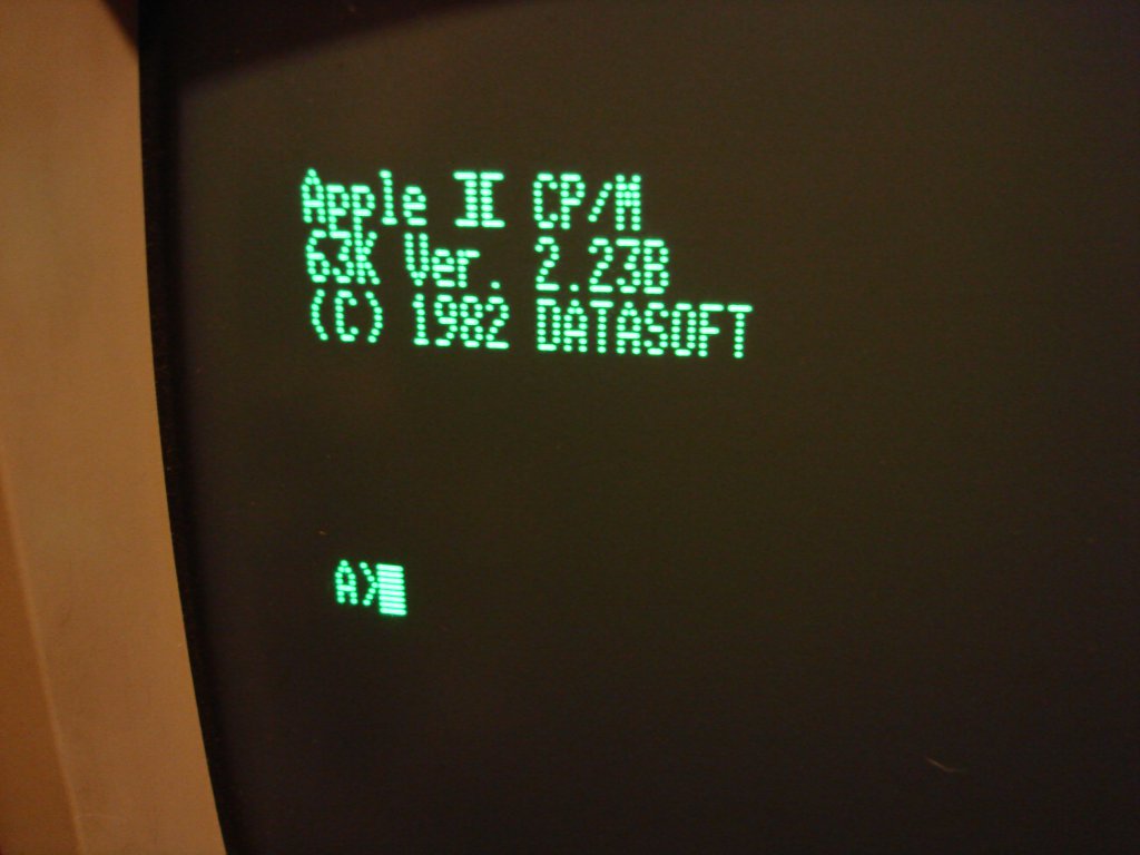

I remember using CP/M on an Apple ][ e which had 64KB of RAM, so I don’t see why it would not be possible technically.
http://www.glitchwrks.com/images/vintage-misc/a2cpm/cpmprompt.jpg
That Apple must’ve had a Z-80 SoftCard, which was a plug-in card with a Z-80 on it and a port of CP/M.
Those were awesome. Except for the part about being limited to 140K diskettes (unless you happened to have a 5M Corvus drive attached).
It was powerful enough, and had enough drive space that I ran a BBS on one for a couple of years.
Never knew that, but it explains to me how an old BBC Micro could run CP/M if you had a Z80 (co-)processor running over the tube interface.
https://en.wikipedia.org/wiki/Tube_(BBC_Micro)
I see my hotlink catcher is working correctly :) That wouldn’t be a picture of *your* IIe, now would it?
Well, I was “Who in this day and age hotlinks” but then I had to look into your site and find that exact picture, nice little project you did there. good to see “Truth” telling the truth ;)
