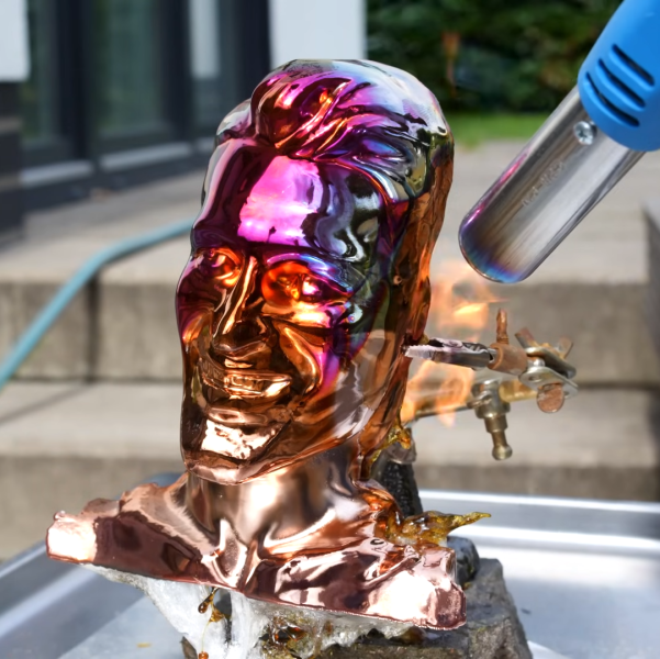

What if you electroplated a plastic 3D print, and then melted off the plastic to leave just the metal behind? [HEN3DRIK] has been experimenting with just such a process, with some impressive results.
For this work, [HEN3DRIK] prints objects in a special PVB “casting filament” which has some useful properties. It can be smoothed with isopropanol, and it’s also intended to be burnt off when used in casting processes. Once the prints come off the printer, [HEN3DRIK] runs a vapor polishing process to improve the surface finish, and then coats the print with copper paint to make the plastic conductive on the surface. From there, the parts are electroplated with copper to create a shiny metallic surface approximately 240 micrometers thick. The final step was to blowtorch out the casting filament to leave behind just a metal shell. The only problem is that all the fire tends to leave an ugly oxide layer on the copper parts, so there’s some finishing work to be done to get them looking shiny again.
We’ve featured [HEN3DRIK]’s work before, particularly involving his creation of electroplated 3D prints with mirror finishes. That might be a great place to start your research if you’re interested in this new work. Video after the break.

  4. Seems like doing the blowtorching in a reducing or intert atmosphere would help a lot with the final finish. Copper is pretty reactive and these things have a lot of surface area to be doing this in plain old air.

    1. FFWD to 7:20 A light brushing and a dip in the acid bath did just fine restoring the shine. Trying to do a second plating over the oxide layer wouldnt have given nearly as clean a result.

            You wouldnt have anything close to precise control with the technique you propose. You want less oxidization, dont use a blow torch. If somehow an oven STILL has too much oxidization, A decent top loading kiln and a bottle of argon has you covered, though if you watched the video, he does a little brushing, then acid dips the parts and gets a nice clean result, even after going to the extreme of heat, using a blowtorch.
