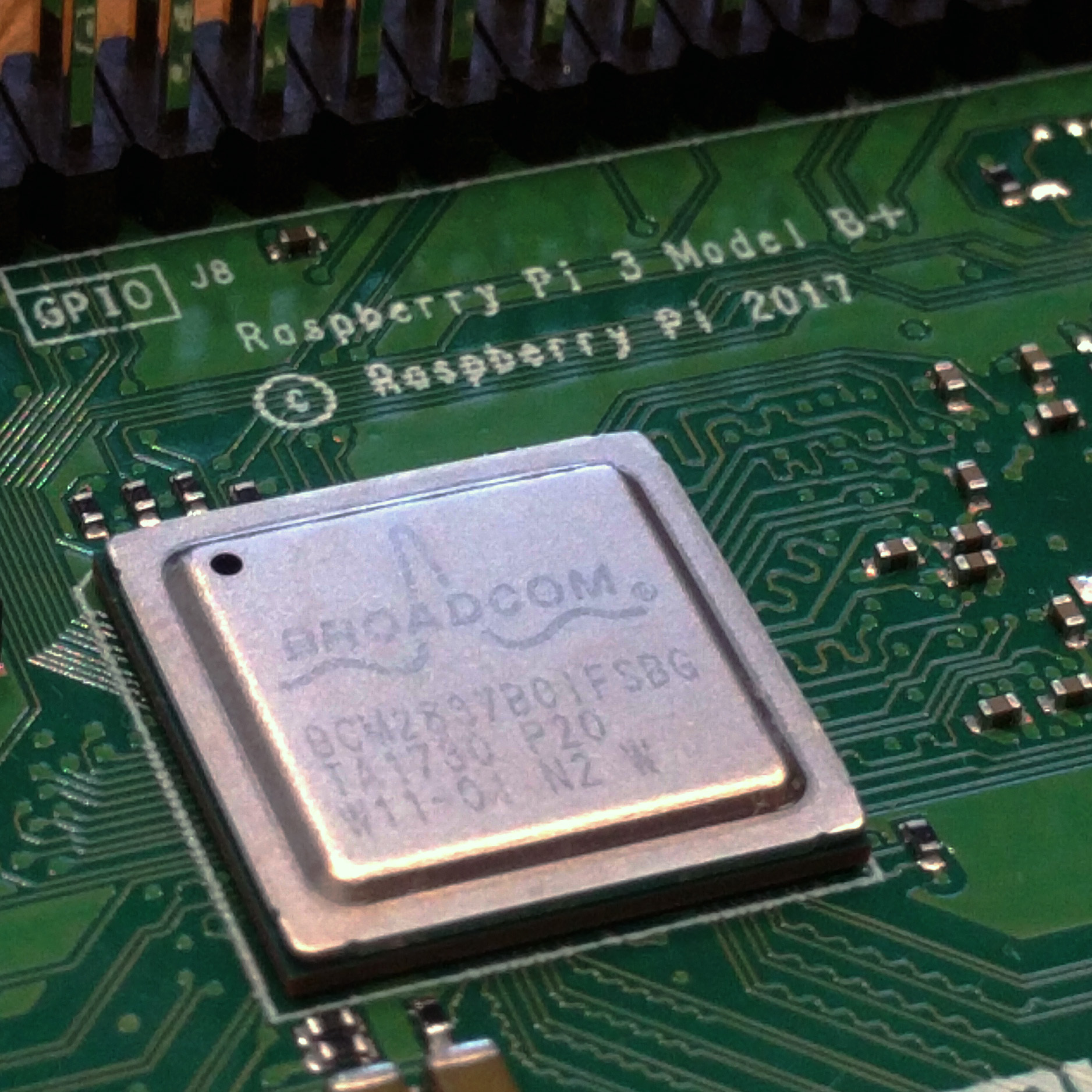

The most visually striking difference between the old Pi 3 and the Pi 3 Model B+ is the embossed metal shield over the RF guts of the board. This houses the new, dual-band 2.4 and 5GHz wireless LAN, and Bluetooth 4.2/BLE. The Pi 3 used a BCM43438, which only supported 2.4GHz WiFi, whereas the new wireless chipset is significantly more capable and able to work with 5GHz networks.
But that metal shield covering the new wireless chipset isn’t just for decoration. The Raspberry Pi 3 Model B+ comes with modular compliance certification. This allows the Pi 3 Model B to be used in products with significantly reduced compliance testing.
Much Better Wired Networking
While these are welcome changes, this isn’t the biggest reveal for the Pi 3 Model B+. Before the introduction of wireless on the Pi 3, the Ethernet was severely constrained by the LAN9514 USB hub and Ethernet controller. This chip provided the four USB ports and Ethernet to the Pi’s SoC, but networking was limited to 100 Mbps in the best case, and somewhere around 80 Mbps in real-world usage.
The Pi 3 Model B+ changes this by replacing the USB and Ethernet controller with a LAN7515. It’s still a capable USB 2.0 hub and Ethernet controller, but this one gives the Pi 3 Model B+ 300 Mbps Ethernet. It’s a great feature if you’re using a Pi as a home server, or just want to send a lot of data to a Pi over a wired network.
So What’s In The Can?
Being the first Raspberry Pi featuring an RF shield, there is the obvious question of what’s under the can?. The bad news is, removing that RF shield will void any warranty, allow the Pi to spew RF everywhere, and there will be no hope of meeting compliance. The good news is that there are some really cool components under there.
The chip responsible for all the wireless functionality is a CYW43455, a Cypress and/or Broadcom part capable of 802.11ac with support for 2.4 and 5GHz WiFi, and Bluetooth 4.2. The Raspberry Pi 3 Model B — last year’s model — featured a BCM43438, that did not include support for 5GHz radios or Bluetooth 4.2.
It’s a welcome addition, but the real story here is the RF shield that helped secure this board’s modular compliance certification. Now you can use this board in a product and won’t have to pay for the expensive intentional radiator testing required of all new products featuring their own home-spun radios.
