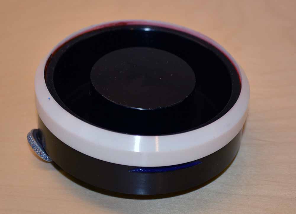

The pad printer I bought is a basic hand-operated system. There are four main parts — the platen, ink cup, silicone pad, and printing plate — all held together by a vast amount of cast aluminum.
  • The ink cup: a steel cup with a ceramic lip that holds the ink against a printing plate.

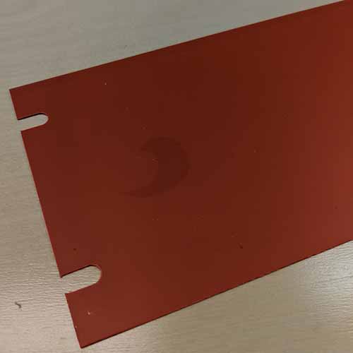

  • The printing plate: while not shown in the above image, is simply a photopolymer plate with a small impression of the desired image.

This is a clever and uncomplicated machine. The ink cup is attached to a moving arm that also holds a silicone pad. When the ink cup slides over the printing plate it deposits the ink. The silicone pad then presses against the plate, picks up the ink, and is moved over to the platen where it’s pressed against the object that will be printed on.

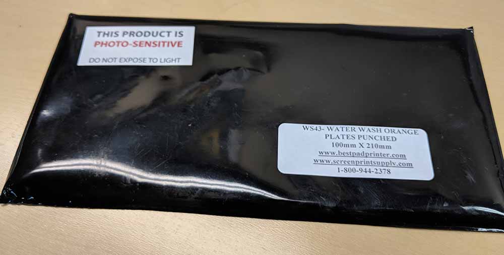

The printing plate, or ‘cliche’ in pad printing parlance, is a steel plate coated with a UV-sensitive photopolymer resin. There are two types of pad printing plates available from my supplier: water wash and alcohol wash. Water wash plates use water to wash away the unexposed photopolymer. Alcohol plates are washed in alcohol to remove unexposed photopolymer.
Simply for ease of developing, I’m using water wash plates, although this does have a few downsides: according to some documentation, water wash plates scratch more easily than alcohol wash plates. Also, water wash plates do not last as long; they’re only good for tens of thousands of impressions, whereas alcohol wash plates are good for a hundred thousand. In your home workshop, your arm is going to wear out before a water wash plate will.

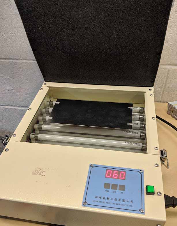

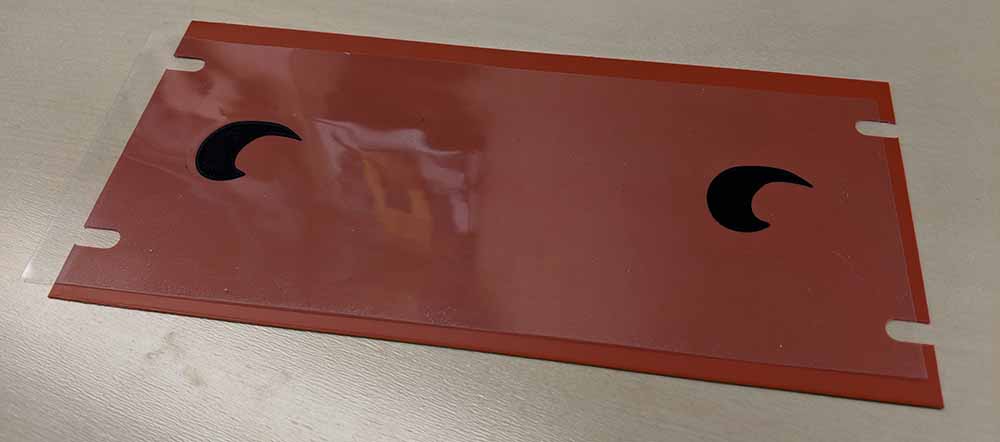

To get the design onto the plate, I first printed the desired image on laser transparency film. I ran this through my laser printer three times to make sure it was sufficiently dark. After this, I peeled the protective sheet off the photopolymer plate, set down the laser printed mask, and put it in the UV plate exposure unit for 120 seconds. This plate exposure unit is simply a few UV fluorescent bulbs in a box with a timer; I’m certain you could also expose a plate with a few UV LEDs.
The instructions I found on the Internet told me to then expose the plate with the halftone pattern sheet. I don’t have experience in photolithography or printing technology otherwise, so I just put the halftone screen over the plate and put it back in the exposure unit for 30 seconds.
After the halftone screening, the plate was washed in warm running water for 2-3 minutes. The plate was then dried in a toaster oven set on ‘low’, and put back in the UV exposure unit for another 15 minutes. The result is the best plate I’ve ever made with this setup, and something that was good enough to make a few Tide pods.
