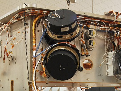

To maintain its orientation, Kepler was outfitted with thrusters and four reaction wheels: flywheels that are used to store angular momentum and apply torque on the spacecraft. Thrusters are ideal when large changes to the spacecraft’s orientation are required, with the reaction wheels reserved for small and precise adjustments. Unfortunately, in 2012 one of Kepler’s reaction wheels started having problems. This left three remaining, which was enough to continue on with the mission, but in 2013 another wheel shut down. With only two functioning reaction wheels the spacecraft was unable to precisely align itself during observations, effectively ending its original mission.
At this point the mission had already accomplished its scientific goals. Even if Kepler never looked at another star again it would have still been a huge success. But as the spacecraft was still largely functional, NASA started looking for a way to utilize it with a revised scientific mission the agency referred to as K2.
Perfect Balance
NASA realized that with only half of the reaction wheels operational, there was no way for Kepler to equally apply torque in all dimensions. Trying to use the two remaining wheels would simply cause the spacecraft to tumble. What NASA needed was a way to apply some sort of pressure on the craft which the remaining reaction wheels could push against. The solution came from a rather surprising place: the sun.
The fix NASA came up with exploits the fact that photons striking the spacecraft exert a constant, if slight, force. By carefully maneuvering Kepler to face the sun in the proper orientation, the two remaining reaction wheels can be used to apply torque in opposition of the solar pressure. Once equilibrium is reached, the spacecraft is balanced well enough that it can continue making observations.
It’s not a perfect solution. Positioning Kepler with this method consumes more thruster propellant than would normally be required, and there’s been a considerable drop in sensitivity due to the fact that this careful balancing act isn’t quite as stable as when orientation was being controlled by all four reaction wheels. But even still, the Kepler K2 mission has managed to collect invaluable scientific data over the last four years from a spacecraft that many wrote off as dead.
