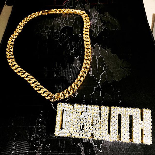

DEAUTH Badge
I think this is the only non-electronic badge I looked into covering this year. Sorry for failing to get it in focus, the bejeweled badge is giving the auto-focus a tough time. That’s because it’s super reflective. El Kentaro told me the badge itself is 3D printed, smoothed, and then covered in multiple coats of gold spray paint. The inset is not just large jewels, but hundreds of tiny glass beats to fill in the gaps between the larger stones.

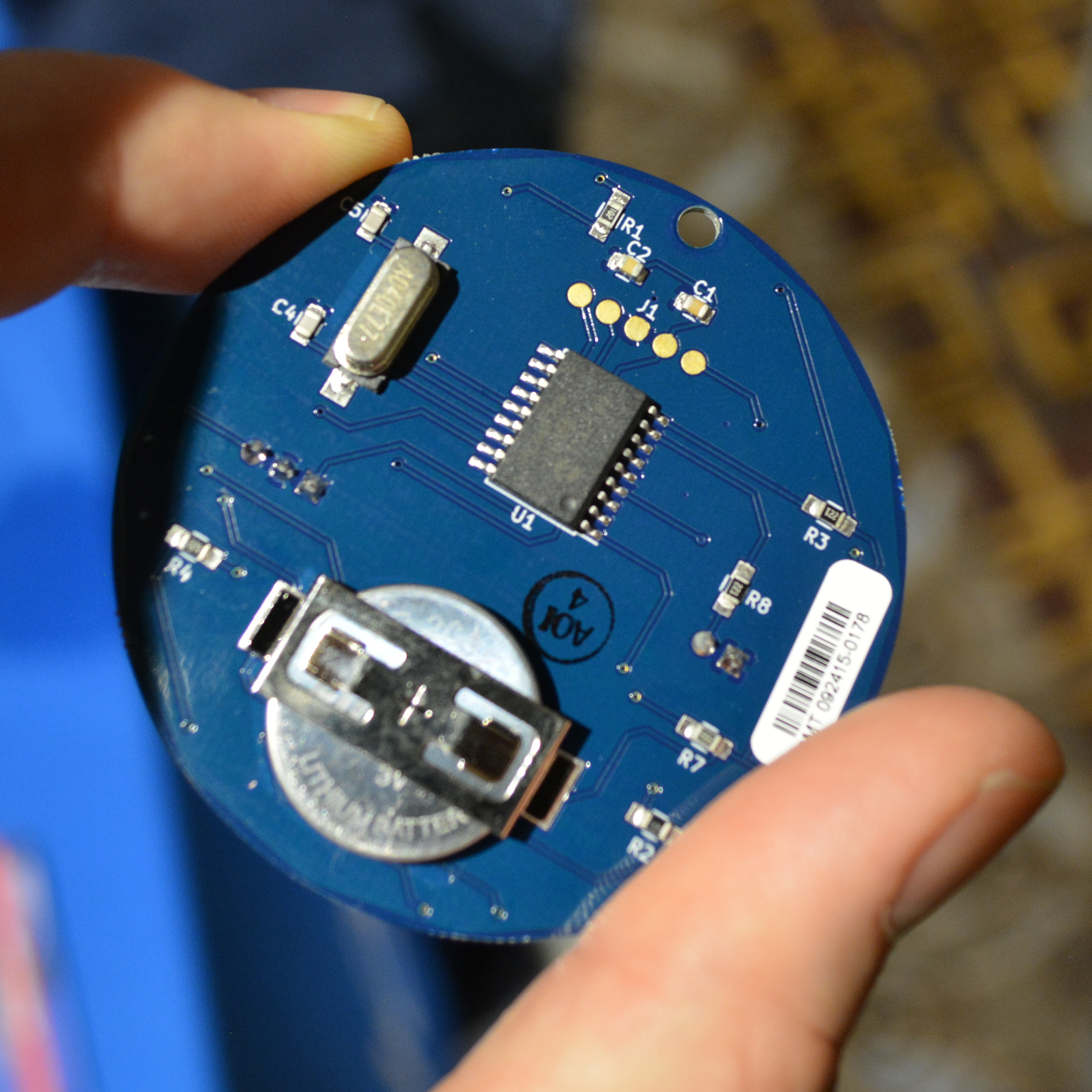

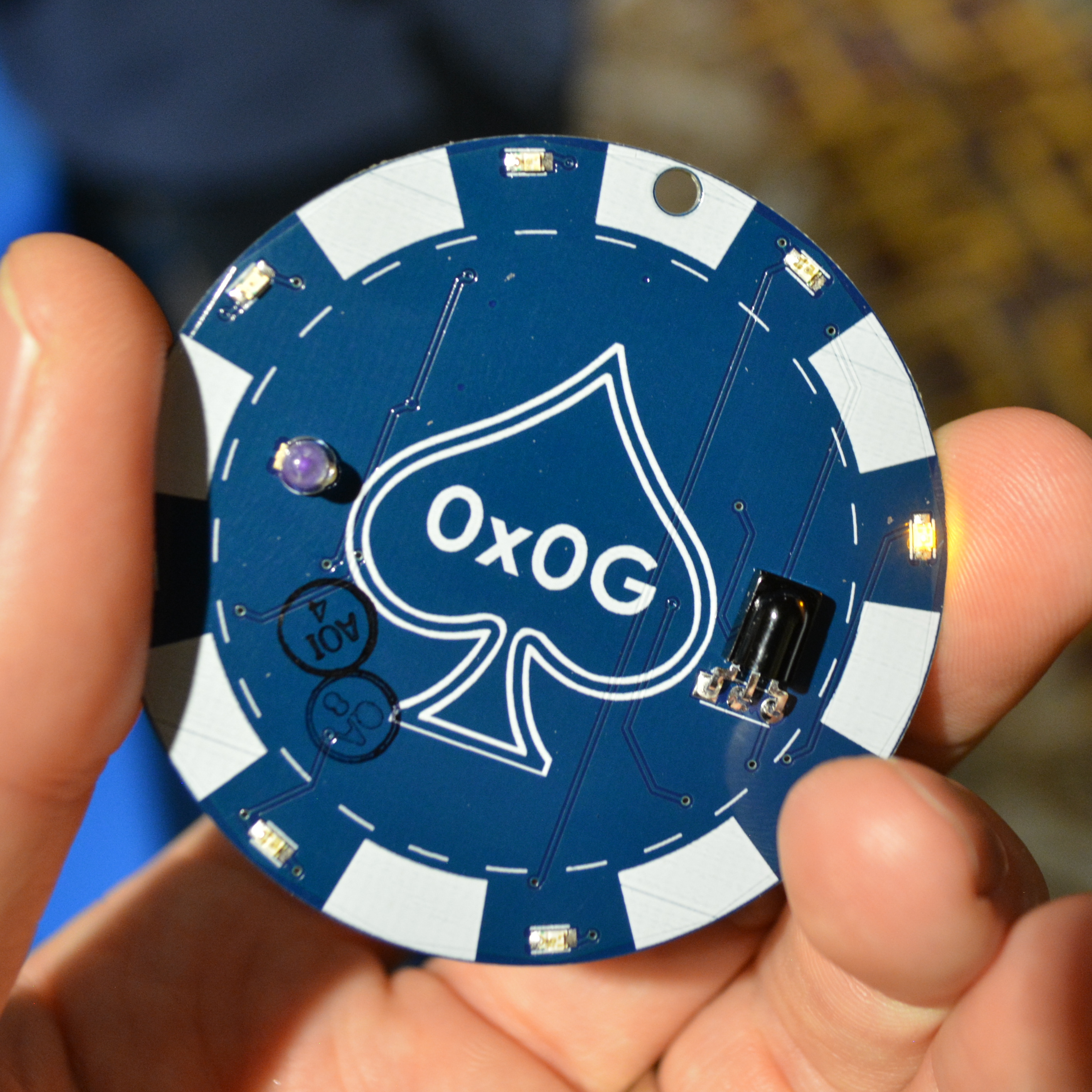

0x0G Badge
Apparently Google has an event at Blackhat/DEF CON each year that I had never heard of it until I ran into TwitchyLiquid64. The badge is designed to look like a casino chip, with LEDs lining the circumference. 520 of them were made and each has an IR receiver and LED, letting the badges change one another’s patterns. I thought it was neat that TwitchyLiquid was using a remote control like you’d see with an LED strip to easily control the badges. Check out more details on the badge’s repository.
