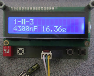

        The capacitance is determined by the aluminum oxide layer formed on the electrodes, so their value doesn’t change much when they are dried out. The ESR suffers because the electrolyte (i.e. liquid) is part of the conductive path. The higher the ESR goes, the higher the heating effects from the I^2*R losses until the cap fails.
        Smaller capacitors have smaller surface area for heat dissipation and holds less liquid, so they are the ones that dries out first.
        I have one failed capacitor in a 120V LED driver. It reads 4.3uF 16.36R where as an old cap of the same size reads 4.8uF 1.8R
        https://3.bp.blogspot.com/-fCHHecFofHM/W1vMYosYpZI/AAAAAAAAAWY/aQoCgfEpAjEMpqrzeej86rCQIBrUQiW-gCLcBGAs/s320/93411527865905993.JPG
