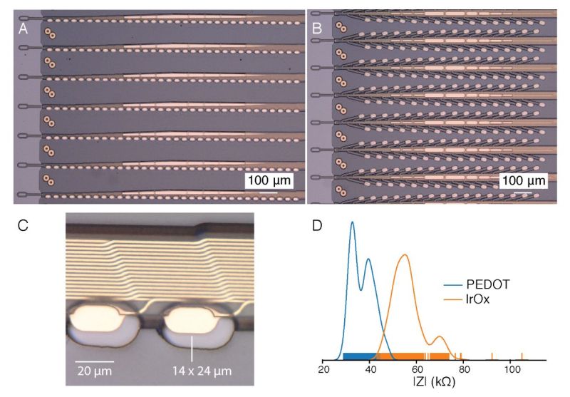

Neuralink developed so-called ‘threads’ which incorporate dozens of individual contacts along the length, with 32 contacts per thread being quoted. By inserting this thread into the grey matter of the target area, they get readings from neurons along the entire length, at various depths. These threads are connected to the device that does the actual sampling. At the moment it’s only been tested with rats, where having the animal survive the experiment is of secondary concern. Ergo it protrudes from the animal’s skull (photograph is in Neuralink’s paper, for the less squeamish), with a USB-C port for easy data access and power delivery.
Assuming that Neuralink can shrink the device to make it easily slot within one’s skull and make it wireless, this invasive procedure would then allow for readings from hundreds to thousands of locations within the brain. If implemented with the dozens to hundreds of threads as suggested by Neuralink officials, then one would get literally thousands to tens of thousands of readings.

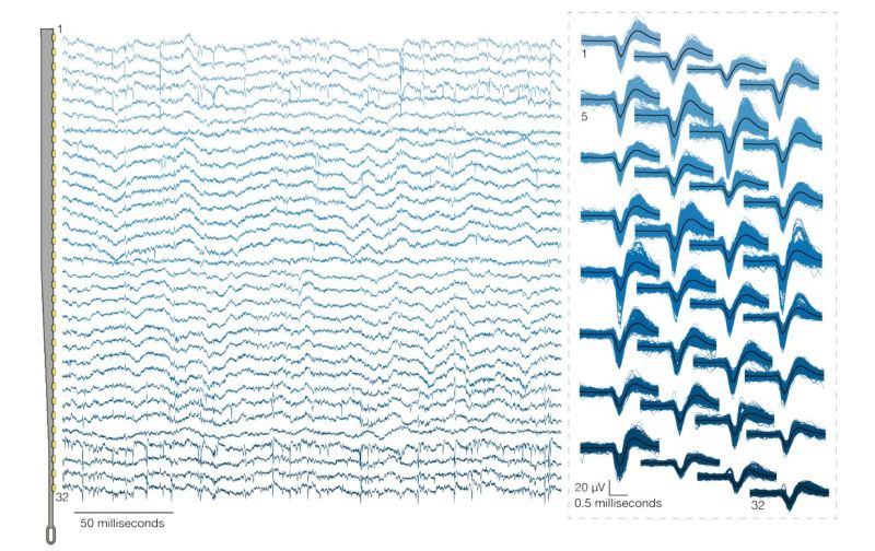

No matter how you collect the data, be it through an external electroencephalogram (EEG) or using invasive sensors, the signals must be processed to decide what the brain is doing. Peaks indicate that one or more neurons experienced an action potential which got picked up by a nearby probe. It is then interpreted in a specific way that considers the location within the brain. If it’s in the motor cortex, then it could mean that the person thought of moving their arm, for example.
The main issue here is that although we have a rough idea of where certain functionality is located in the brain based on prior experiments (and people suffering brain damage during accidents, such as the famous case of Phineas Gage), there’s still a lot we do not know. This is greatly complicated when moving from one person to the next. Human beings are not perfect carbon copies of each other, and our brains are constantly changing their exact layout. Positioning of functionality is tricky.
Research teams at universities around the world have been trying to map spoken words from people who had electrodes embedded in their brains while undergoing surgery, or as part of epilepsy treatment. That Science magazine article reveals that researchers find this task to be far from easy. Even though they were able to hear what the people are saying during invasive monitoring of brain activity, attempts at decoding the brain signal only reached somewhere between 40% and 80% accuracy.
Without such an extended training session — such as when a person cannot speak at all — it’d be nigh impossible to map those vocalizations to specific brain patterns. This is also because speech isn’t just produced by a single part of the brain, but distributed throughout the brain, from the motor cortex to the linguistic center, to sections involved in speech planning.
Essentially, we’re still only beginning to figure out what is needed to understand these signals which we are receiving from the probes embedded in the brains of animals and ourselves. We can already do amazing things with training and calibration, but we’re clearly not even close to the type of brain-computer interface we see in science fiction.

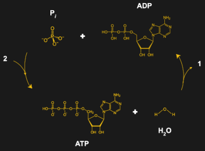

My biology teacher told us that the (average) body makes and consumes around 180 pounds of ATP each day.
Is that somewhat like claiming my car revolved a 100,000 tonnes of tyre on my way to work this morning?
Good analogy. Obviously it’s overwhelmingly the same ATP, otherwise we’d certainly need to eat a lot every day!
It’s actually not, because ATP is broken down as it is used. ATP -> ADP/AMP -> ATP
The analogy would hold if you re-treaded your tired after every revolution.
It’s similar to saying that your heart pumps 7000 liters of blood every day.

Leading ‘current’ generation of implanted brain-recording probes, with less hype and Musk, would be NeuroPixels:
https://www.neuropixels.org/
“Control your NeoPixels with NeuroPixels!”
