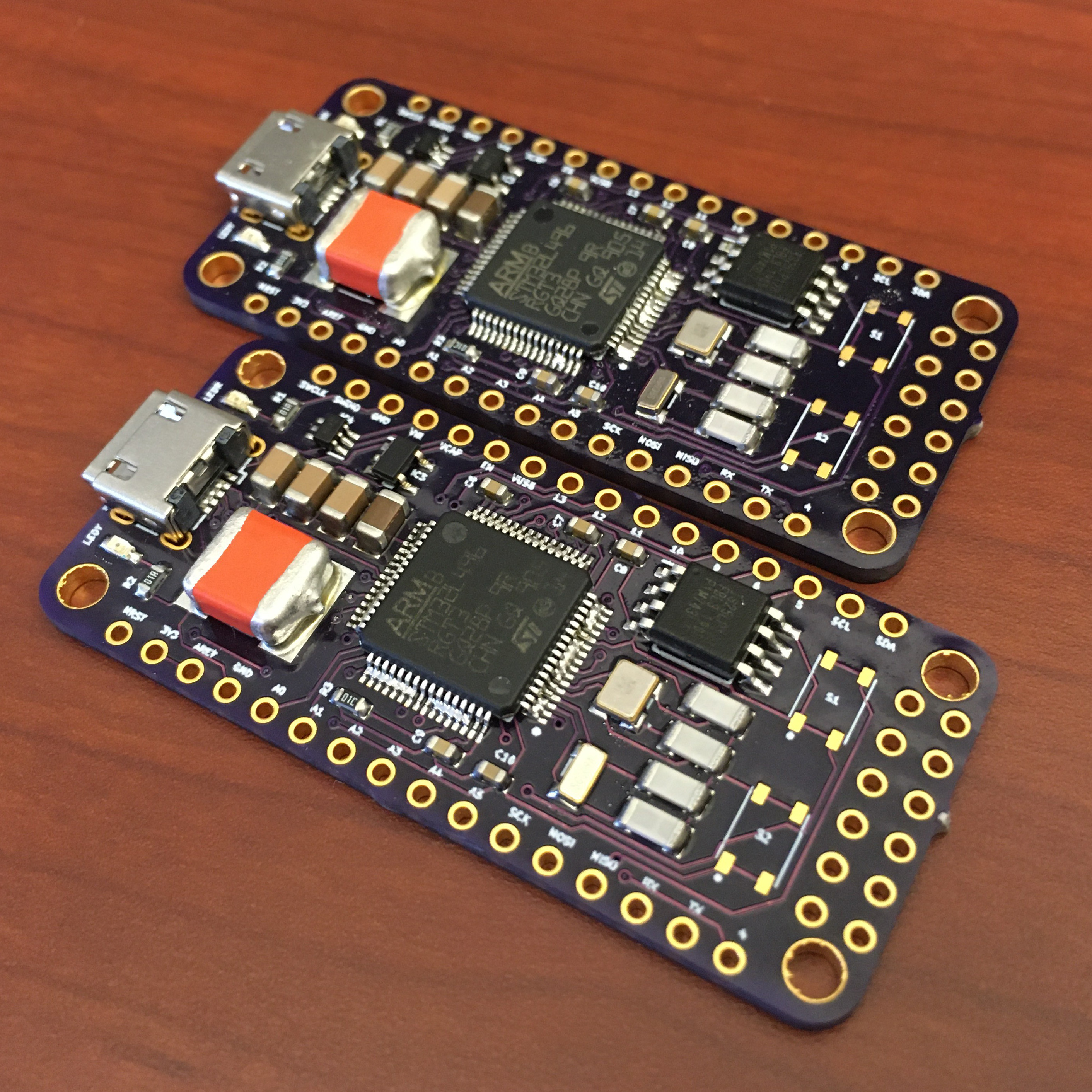

Feathers in Space? That’s the goal of the Junebug project which has designed a Feather compatible brain for small satellites. Perhaps most interesting is that it’s designed to function without a battery, something known as intermittent computing. Junebug takes the You’ll Cut Yourself On That Edge title.

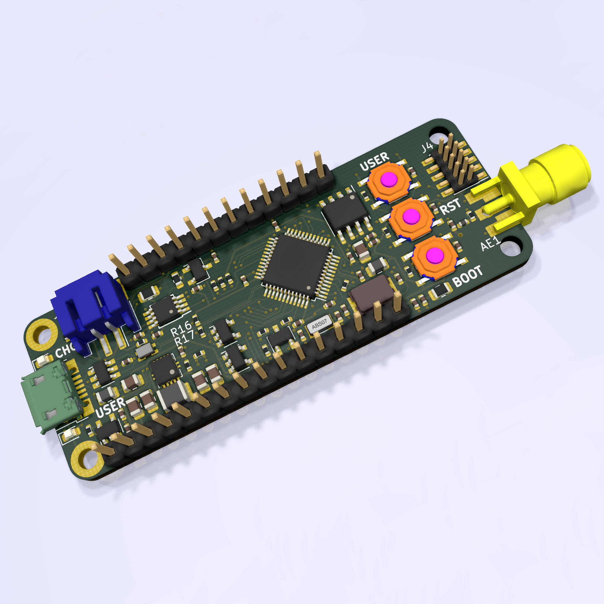

In other “far out there” designs is the LoRaWAN Feather, designed to get you and up and running with the long-distance communications protocol that is all the rage these days. If fittingly takes the Wireless Feather title.

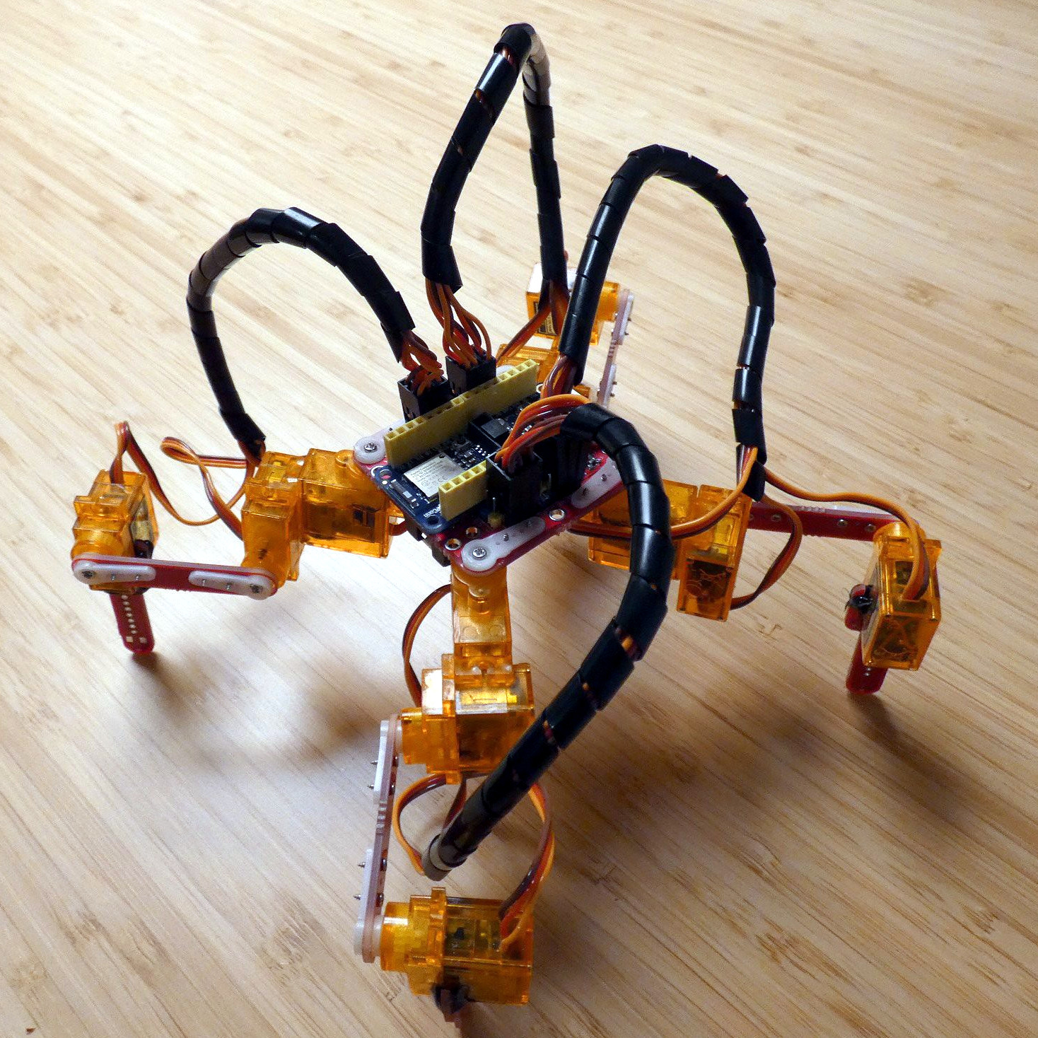

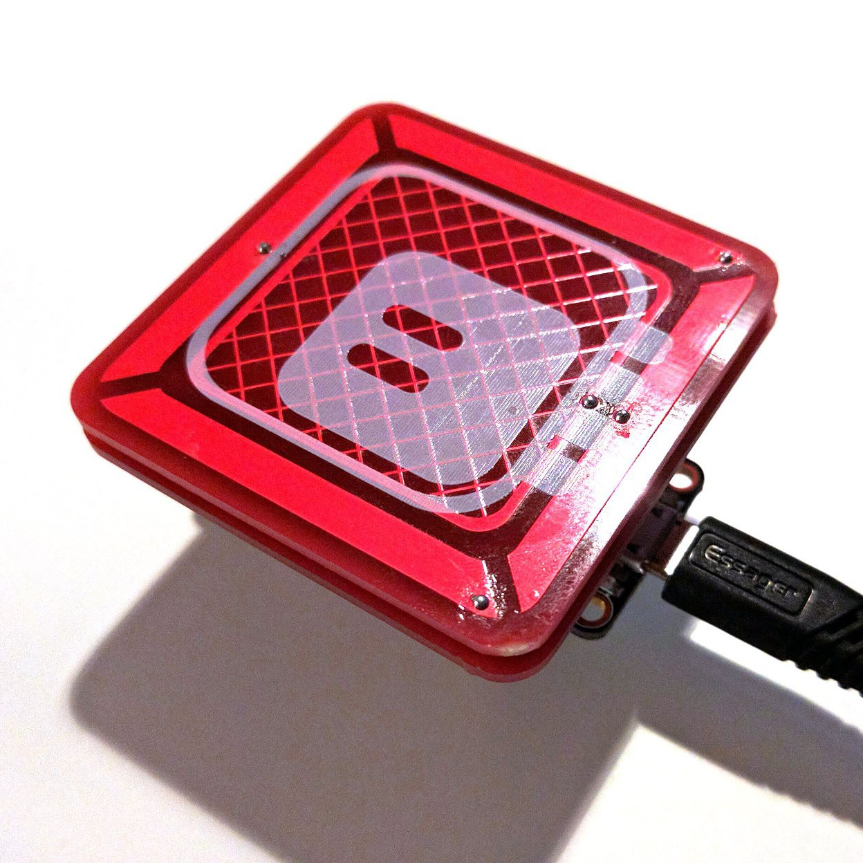

The SpiderWing is sure to give you the creepy-crawlies as it ticks around on four legs made out of twelve micro servos. Perhaps you can control it using another design by the same hacker, the Gesture FeatherWing uses an MCP3030 for an input device that recognizes patterns drawn by your finger. These creations take the Weirdest Feather and the Assistive Technology titles.
