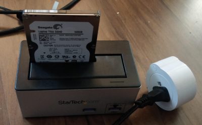

If you think that spending hours power cycling a hard drive doesn’t sound like a fun task, and is something that should be automated, then you’re right. It’s easy enough to wrap our ddrescue command in a loop, ideally along with five seconds of sleep. That handles half the problem, but power cycling the drive isn’t a software problem. I’ve used Adafruit’s power switch tail in the past, connected to a Raspberry Pi GPIO pin, to kill the drive’s power supply every 30 seconds. It’s not ideal, but it works. Unfortunately that device is discontinued, and I’m not aware of a direct replacement.
The last time I ran into this problem, I used a WiFi power switch, pictured above. Whenever the device disappeared, the script triggered the plug to power cycle the drive. This worked, and on a 500 GB drive, I recovered all but the last 1.5 megs. The only downside is that the smart plug only works via the cloud, so every power cycle required a request sent to the IFTTT cloud. Leaving the drive running overnight resulted in too many requests, and my account was frozen. Next time, Ill have to use a device that supports one of the open source firmwares, like Tasmota. Regardless, the script is simple:
while true; do
    sudo ddrescue /dev/sda diskimage.img mapfile.log
    if [ -a /dev/sdc ]; then
        sudo ddrescue /dev/sda diskimage.img mapfile.log -M
    else
        curl -X POST https://maker.ifttt.com/trigger/switch_off/with/key/REDACTED
        sleep 10
        curl -X POST https://maker.ifttt.com/trigger/switch_on/with/key/REDACTED
        sleep 10
    fi
done
If the device disappears, use the switch to power cycle the drive. If ddrescue completes, and the device is still present, then use the -M switch to mark all the bad sectors as untried.
In many cases, this isn’t a process that ever really finishes, but the rate of recovery eventually drops too low to be worth continuing. Once you’ve copied as much of the raw data off the drive as possible, it’s a good idea to use fsck/chkdsk to repair the now-rescued filesystem. If it’s a system drive, after you burn it to a new disk, you’ll want to use your OS’s tools to verify the system files. For Windows, I’ve had good success with SFC and DISM. On Linux, use your system’s package manager to verify your installed packages. On a Fedora/Red Hat system, rpm -Va will show any installed binaries that have unexpected contents.
Over the years I’ve rescued a handful of drives with ddrescue, that other techniques just wouldn’t touch. It’s true that a good backup is the ideal solution, but if you find yourself in a situation where you really need to get data off a dying drive, ddrescue might just be your saving grace. Good luck!

    A few years ago, I tried recovering a failing laptop SATA HDD. The drive would “disappear” whenever reading a bad sector; it seemed like its firmware was confused by a lack of spare sectors, as this article mentioned.
    After some creative google-fu, I figured a way to use the recovery PC’s power management to automate cycling the drive’s power. This eliminated an unreasonable amount of hand-holding, but there was already a fair bit of scattered damage, and ddrescue had increasing difficulty finding good sectors, until basically nothing was readable. Ultimately the laptop was RMA’d under warranty. YMMV.
    Here’s the script I used:
    DEV=sda; while true; do
    # some of these flags were an attempt to aggressively skip over bad sectors
    # "-e +$n" ensures ddrescue exits after errors, so the script can continue
    ddrescue -vvvv -d -e +8 -n -N -c 1 -K 1Mi /dev/${DEV} ${DEV}.dsk ${DEV}-ddrescue.log
    # make sure device is removed
    echo 1 > /sys/block/${DEV}/device/delete
    # power off drive by sleeping the whole PC
    rtcwake -m mem -s 3
    # re-add "newly inserted" drive
    echo "- - -" > /sys/class/scsi_host/host0/scan
    sleep 2
    # just FFR: "[12345.678901] end_request: I/O error, dev sda, sector 123456789"
    dmesg -c | grep sector >>${DEV}-crash-sectors.log
    done
