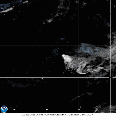

The photo of Esther looks decidedly low-tech today. Compare it to this recent image from the GOES satellite of a storm forming:
Modern image of a tropical storm from space
Hurricane forecasts are now better than ever, especially for position, while intensity forecasts still cause some problems. In addition to getting information to the general public, this is also a boon to the citizen scientist. The data is available if you want to study it, or maybe just to build your own early warning system.
