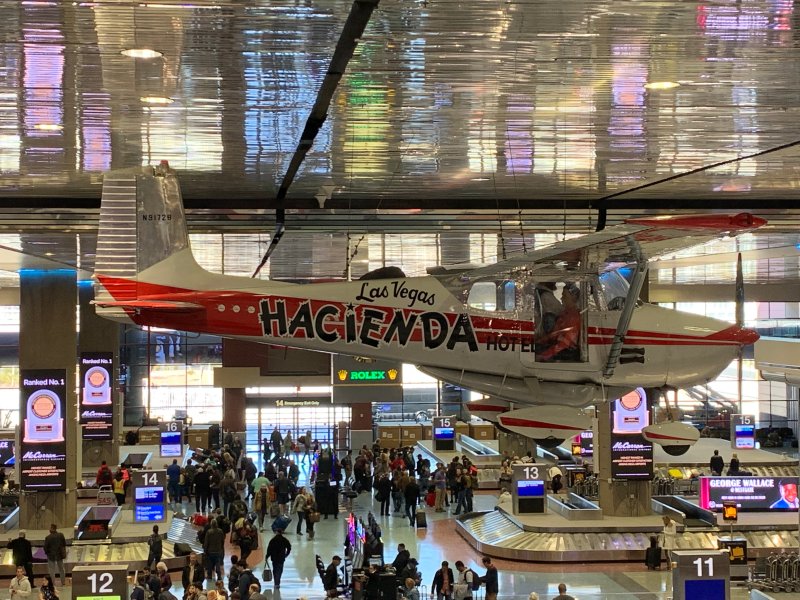

The plane now hangs in McCarran International Airport. Note the sliding door on the co-pilot’s side, and the belly tank underneath. Source: McCarran Airport
