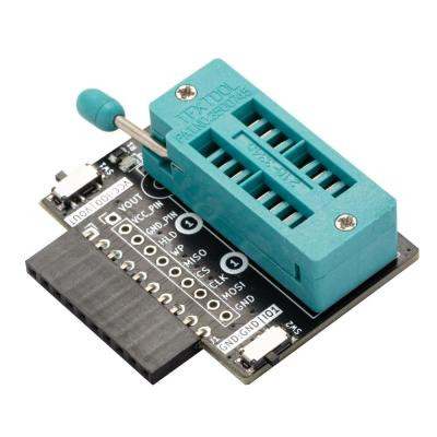

Bus Pirate planks aren’t just limited to DIY. Since releasing the Bus Pirate 5, a number of official planks have been introduced. Some of these are still in development, such as the “IR Toy” that [Ian] has been documenting in a thread on the forums. Others are already available for purchase, such as an assortment of adapters that make it easier to work with SPI flash chips and one for interfacing with SLE4442 Secure Memory Cards.
One of the advantages of the official planks is that the firmware is likely to get baked-in support for any special functions they may have. Even though the IR Toy hasn’t officially been released, last week a new mode was added to the stable build of the firmware that can interface with it and send NEC IR codes. Then again, as the firmware is open source, even DIY planks could get their own modes should somebody be so inclined to write the code for them.
