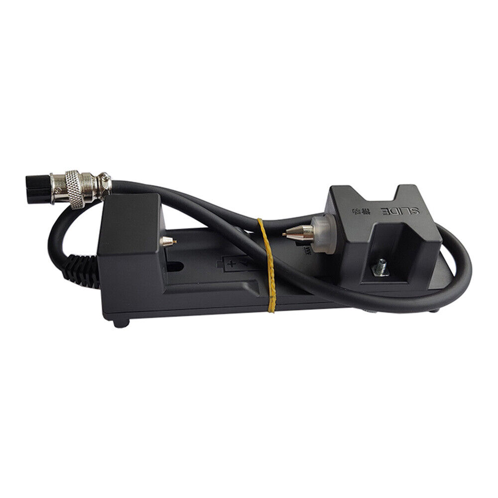

  1. All this (rightful) concern over internal resistance and its measurement, but we almost never see a proper 4-wire Kelvin connection to measure it. https://en.wikipedia.org/wiki/Four-terminal_sensing
    I know why: It’s because any battery clips or terminals you buy have only the single connection for each terminal.
    Has anybody come up with a repeatable, manufacturable Kelvin connection for (say) a 18650 cell?
      1. Cool. Thanks. Now that looks like something you can whip up janky-style with a couple of retractable ballpoint pen tips.
        (And walmart? srsly? )
      2. +1 for the YR1035, I use it to test cells building packs for small vehicles, where the IR is often milliohms. The thing it gets right is the spring loaded 4 terminal probes and cell holder. Critically important for reliable and repeatable measurements.
        1. Coaxial doesn’t just mean “coaxial cable” – in this context it’s referring to the connector at each side of the battery holder, which has an inner and outer connector.
    1. Tuck thin copper shims between each battery terminal and the power contacts, and clip your voltage probes to the shims? That way you’re measuring the battery potential AT the battery. Resistance across the shim’s thickness should be negligible, assuming it’s clean.
