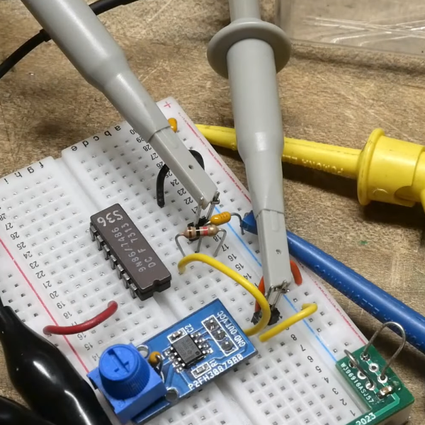

[IMSAI Guy] grabbed an obsolete XOR gate and tried a classic circuit to turn it into a frequency doubler. Of course, being an old part, it won’t work at very high frequencies, but the circuit is super simple, just using the gate and an RC network. You can see a video of his exploration below.
The simple circuit seems like it should work, but in practice, it needed an extra component. In theory, the RC circuit acts as an edge detector. So, each edge of the input signal causes a pulse on the output as the second input lags the first.
That sounds good, but it looked terrible on the scope until a 1K resistor tied to the capacitor shifted the bias point of the gate. In all fairness, the original schematic used a Schmitt trigger gate, which may have made a difference had one been available. There were slight differences, though, depending on the type of device. An LS part, for example, didn’t need the extra resistor.
Of course, an RC network is just one way to delay the input, and the delay determines the width of the output pulse and constrains the input frequency and duty cycle. However, you could use other gates, including the other XOR gates in the package to realize a fast delay.

  1. Circuits like this do work, sort of, most of the time. It’s usable for a quick hack and experiments, but it’s not something you can rely on for bigger production runs, such as selling kits. The reason is that the logic input thesholds are not very well defined, and as a result, the circuit may misbehave when used with a different batch of IC’s, or IC’s from another manufacturer. Just like relying on the Beta of a BJT, it’s not good design practice.

      It’s never good design practice to build a digital logic circuit / system–on which the deterministic, highly repeatable operation of the system depends–using discrete reactive components.
      This is the reason one does not find monostable multivibrator ICs (e.g., the 74xx121; 74xx123; 4538B) nor SE/NE555s in the basic-system design of mission-critical, or life-critical, digital designs.

  4. You can use a 74122 to construct a very clean pulse. That is probably how it would have been done in the day.
  5. There’s a better way – use the remaining ’86 gates as a delay line to get clean and predictable output pulses. That was a standard circuit some decades ago, often to be found in data separator and clock recovery circuits.
