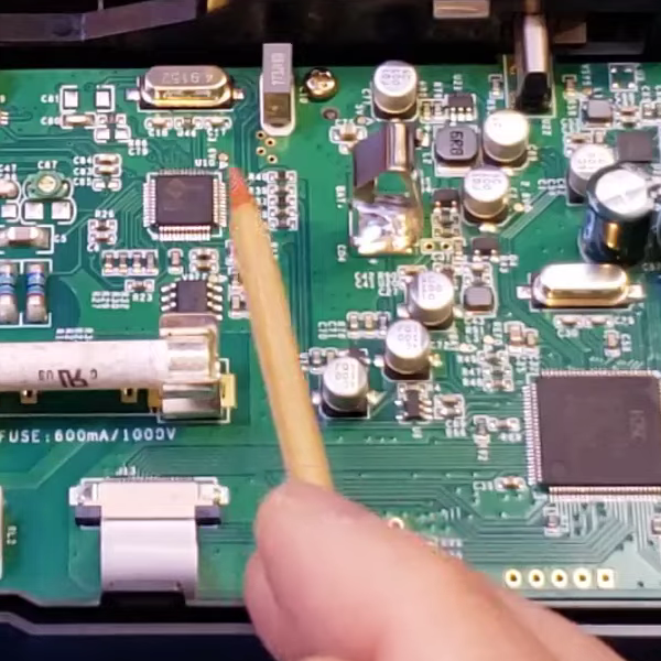

These days, if you are in the market for a capable digital voltmeter, you might as well consider getting one with an oscilloscope built-in. One choice is the Owon HDS160, which [Kerry Wong] covers in the video below. The model is very similar to the HDS120, but the multimeter in the HDS160 has more counts–60,000 vs 20,000 as you might expect from the model number.
The internal chip is an HY3131, which is rated at 50,000 counts which is odd since the meter is 60,000 counts, but presumably the meter uses some capability of the chip, possibly putting it out of spec. The oscilloscope is the same between the two models. Almost everything else works the same, other than the capacitance measuring feature, as the video shows.

  1. The internal chip is an HY3131, which is rated at 50,000 counts which is odd since the meter is 60,000 counts, but presumably the meter uses some capability of the chip, possibly putting it out of spec
    Or they could be outright lying. That’s kind of least hypothesis here.
    1. That’s kind of difficult to lie about on a meter because it has a direct effect on the digits displayed, the resolution, when ranges change etc so it should be really easy to check.
      1. HY3131 has a SPI interface to some external uC. It certainly does not have a display driver for a high-resolution display as used in the Owon. Sniffing this SPI bus is quite easy, but it does take some effort. The additional uC could fudge the numbers. Do some scaling and filtering.
        Looks like Keysight U1282A (An EUR 750 meter) also uses HY3131 and this is also a 60k count meter. This makes it more likely that the 60k count is some feature of the HY3131, but the difference is quite curious.
        1. I strongly doubt Keysight would lie but I do wonder if there’s some processing trickery going on with the data from the HY3131
          1. The first ADC in the HY3131 is 24 bits. So, we could call this 16 million count meter. But the effective number of noise free bits is certainly less than 24. Normal practice with ADCs like this would be average of filter the raw data and to use only some of the most significant bits of the output.
            They are probably not quantizing the data quite as much as was assumed when the chip was called at “50,000 count” meter.
