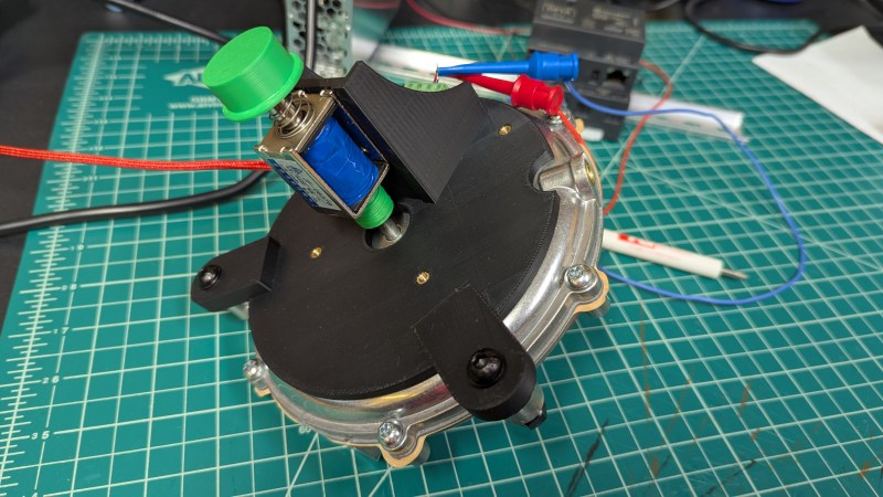

For my winter project this year, I chose something I’ve been itching to try for a while: an auto-starter for my generator. Currently, my solar PV system automatically charges its battery bank when the state of charge (SOC) drops below 50%, which it does with alarming frequency during these short, dark days. But rather than relying on shore power, I want my generator to kick on to top off the batteries, then turn itself off when the charge is complete.
Primer assembly for the generator auto-start. The silver part is the regulator; the solenoid pushes the primer button when it fires. All the parts needed to be custom-made.
In concept, it’s a simple project, since the inverter panel I chose has dry contacts that can trigger based on SOC. It seems like a pretty easy job, just a microcontroller to sense when the inverter is calling for a charge and some relays to kick the generator on. It’s a little — OK, a lot — more complicated than that when you think about it, since you have to make sure the generator actually cranks over, you’ve got to include fail-safes so the generator doesn’t just keep cranking endlessly if it doesn’t catch, and you have to make everything work robustly in an electrically and mechanically noisy environment.
However, in my case, the most challenging aspect is dealing with the mechatronics of the project. My generator is fueled by propane, which means there’s a low-pressure regulator that needs to be primed before cranking the starter. When cranking the generator manually, you just push the primer button a few times to get enough propane into the fuel intake and turn the key. Automating this process, though, is another matter, one that will surely require custom parts, and the easiest path to that would be 3D printing.
But, up until a couple of weeks ago, I didn’t own a 3D printer. I know, it’s hard to believe someone who writes for Hackaday for a living wouldn’t own one of the essential bits of hacker kit, but there it is. To be fair to myself, I did dip my toe into additive manufacturing about six or seven years ago, but that printer was pretty awful and never really turned out great prints. It seemed like this project, with its potential need for many custom parts, was the perfect excuse to finally get a “big boy” printer.

  9. For my Electric Start Duel Fuel Generator, I ended up putting a Solenoid Operated Primer in Line with the Starter and Liquid Feed Valve, with a Vacuum Switch to keep the Liquid Line Open.
    When the Starter Hits, the Primer and Liquid Propane Feed come on, when the Vacuum Switch Makes, the Machine is Running, the Starter Stops, The Primer Stops, and the Vacuum Switch keeps the Liquid Feed Open.
    Think it was an Impco Kit I added for my 20 HP 4 Cylinder Wisconsin Engine.
    If I start it on Gasoline (Petrol) then Normal Chocking Applies, and I have to Manually Start it, and Close the Throttle By hand, because the speed Control wants to keep the Throttle wide open during Starts..
    Starts fine on Propane, Gasoline is by hand only.
