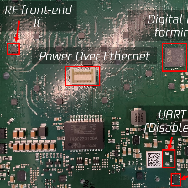

The terminal consists of two parts: the router and the antenna. In this context, antenna is somewhat of a misnomer, since it is really the RF transceiver and antenna all together. The post looks only at the “antenna” part of the terminal.
The unit is 100% full of printed circuit board with many RF chips and a custom ST Microelectronics Cortex A-53 quad-core CPU. There was a hack to gain root shell on the device. This led to SpaceX disabling the UART via a firmware update. However, there is still a way to break in.
[DarkNavy] wanted to look at the code, too, but there was no easy way to dump the flash memory. Desoldering the eMMC chip and reading it was, however, productive. The next step was to create a virtual environment to run the software under Qemu.
There were a few security questions raised. We wouldn’t call them red flags, per see, but maybe pink flags. For example, there are 41 trusted ssh keys placed in the device’s authorized_keys file. That seems like a lot for a production device on your network, but it isn’t any smoking gun.

  3. I can’t imagine what they must be paying for such a massive impedance controlled PC board
    Also anyone knows what the RF front end IC is? A part number maybe?
    1. They’re really not expensive in bulk. I’d actually be surprised if it’s impedance controlled, though, it’s easier to just design to the stack up and deal with the tolerance variations.
      Given the fact that they don’t shield like, anything, my guess is they’re dealing with it via the time tested method of “more power.”
