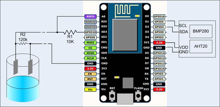

The hack we have for you today is among our most favorite types of hack: a good, honest, simple, and well documented implementation that meets a real need. Our hacker [Solo Pilot] has sent in a link to their basement monitor.
The documentation is quite good. It’s terse but comprehensive with links to related information. It covers the background, requirements, hardware design, sensors, email and SMS alerts, software details, and even has some credits at the end.
Implementing this project would be a good activity for someone who has already made an LED flash and wants to take their skills to the next level by sourcing and assembling the hardware and then configuring, compiling, deploying, and testing the software for this real-world project.
To make this project work you will need to know your way around the Arduino IDE in order to build the software from the src.zip file included with the documentation (hint: extract the files from src.zip into a directory called AHT20_BMP280 before opening AHT20_BMP280.ino and make sure you add necessary boards and libraries).

Detecting water is almost trivial: two electrodes have to be mechanically positioned such that water will complete a circuit between them. What’s much harder is getting that information to the right place so that damage can be prevented to the maximum extent possible.
If you’re home 24x7x52, a shrieking alarm may be adequate. But whenever you leave the house it’s unprotected. Being able to receive the sensor notification outside of the home is good. Being able to shut off the source of the water before you even get notified is better.
An ESP8266 has enough power to handle the WiFi communications reliably, and be configured to send the notification to a home automation system which can trigger the appropriate alerts and actions, like shutting off the water valve. You get a large amount of risk mitigation for an investment of $3.00 and some brainpower.

No designer with half a brain will run DC to water sensor electrodes. UGH.
I still use the ESP8266 for a security system and it works great. The ESP32 has too much computing power/current drain/library issues.
Except that here, from what I understand, it is not a water level sensor, just a switch. For a moisture sensor in soil, sure. But as a alarm trigger? I don’t see the problem here.
If you absolutely have to leave negative comments, maybe some constructive criticism? Explain why it’s bad, and how you would do it?
So,
With that rather condescending reply, would you care to explain why?
Ignore Kelly’s misguided comment. They are confusing a water contact sensor with a [soil] moisture sensor. A moisture sensor is seldom truly dry, so DC can quickly cause corrosion of the sensor due to a trickle of current flowing in the same direction all the time. AC causes corrosion too; it just takes longer. But for a sensor like the one in this article, DC is actually an excellent choice since it only has to conduct current for a few seconds to save a basement. Prior to a flood, the dry sensor would not corrode. The use of AC would complicate the design but would not improve its operation.
