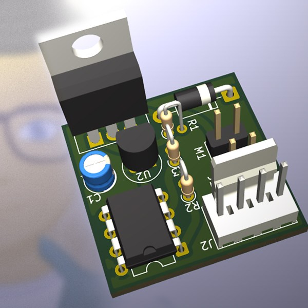

When your GPU fan goes rogue with an unholy screech, you either shell out for a new one or you go full hacker mode. Well, [ashafq] did the latter. The result is a delightfully nerdy fan controller powered by an ATTiny85 and governed by a DS18B20 temperature sensor. We all know a silent workstation is golden, and there’s no fun in throwing money at an off-the-shelf solution. [ashafq]’s custom build transforms a whiny Radeon RX 550 into a cool, quiet operator. Best of all: it’s built from bits likely already in your junk drawer.
To challenge himself a bit, [ashafq] rolled his own temperature-triggered PWM logic using 1-wire protocol on an ATtiny85, all without libraries or bloated firmware. The fan’s speed only ramps up when the GPU gets toasty, just like it should. It’s efficient and clever, and that makes it a fine hack. The entire system runs off a scavenged 12V fan. He could have used a 3D printer, but decided to stick onto the card with double-sided tape. McGyver would approve.
The results don’t lie: idle temps at 40 °C, load peaking at 60 °C. Quieter than stock, smarter than stock, and way cheaper too. The double-sided tape may not last, but that leaves room for improvement. In case you want to start on it yourself, read the full write-up and feel inspired to build your own. Hackaday.io is ready for the documentation of your take on it.

  2. Junk drawer parts indeed. That temperature sensor is long obsolete. It also cost ten times what the ATTiny cost. I use a plain old NTC thermistor for this, like every fan manufacturer uses. It costs a tenth as much as the microcontroller.
    And if your junk box is even modestly well stocked you’ll have a PWM-controlled fan, so won’t even need that relatively expensive MOSFET. Of course, then the solution can reduce to just a GPIO pin and a bit of software, assuming you have access to that.

  3. From the PCB, it is clearly that the DS18B20 (U2) is mounted on the PCB instead of mount on heatsink or GPU, so what is measured is the ambient temperature instead of the actual temperature on the surface of the GPU. Personally I would cut a strip of a coke can and use it to make a holder and screw it together with the DS18B20 on the surface of the heatsink or something to get a more accurate temperature.
