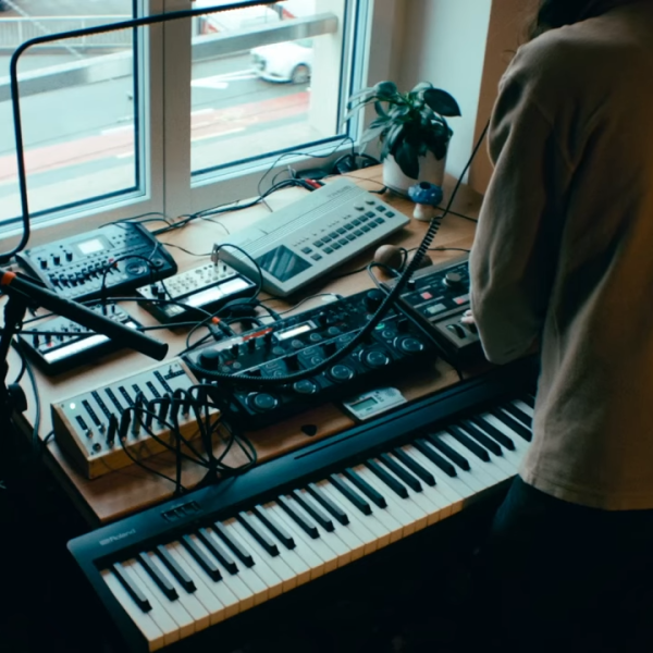

There are plenty of audio mixers on the market, and the vast majority all look the same. If you wanted something different, or just a nice learning experience, you could craft your own instead. That’s precisely what [Something Physical] did.
The build was inspired by an earlier 3-channel mixer designed by [Moritz Klein]. This project stretches to eight channels, which is nice, because somehow it feels right that a mixer’s total channels always land on a multiple of four. As you might expect, the internals are fairly straightforward—it’s just about lacing together all the separate op-amp gain stages, pots, and jacks, as well as a power LED so you can tell when it’s switched on. It’s all wrapped up in a slant-faced wooden box with an aluminum face plate and Dymo labels. Old-school, functional, and fit for purpose.
It’s a simple build, but a satisfying one; there’s something beautiful about recording on audio gear you’ve hewn yourself. Once you’ve built your mixer, you might like to experiment in the weird world of no-input mixing. Video after the break.
This is a fun project! The enclosure is beautiful. Meters would be nice; maybe on the next iteration. But if I’m not bitchin’ I’m not breathin’.

All-caps Dymo? You say retro, I say cheezy. and this native English reader finds them barely legible, they need to be flipped around so the “P” in “PIANO” is at the top where the “O” is in the photo. The industry standard is that English reads right to left, top to bottom. Custom refrigerator magnets would be one solution; for cheap use existing refrigerator magnets, a *grown-up” label maker and an X-Acto knife.

Back to the mixer project, a meaningful improvement (in my opinion) would be to put the audio cable receptacles on the front face rather than the top. Assembly becomes more challenging but the user experience could be so much better.
If you’re “across the room” you have no reason to be looking at the board. Like what you say about audio cables and where they get jammed in but I suspect the industry standard is for good reasons to jam your male plug into the rear. Keep the cables out of way: don’t accidently disconnect none with your foot or bong, won’t be none. The potentiometer knobs/spindles are perhaps the least well executed part of the project: if you insist on knobs/spindles at least throw some some Telecaster knobs or numbered knobs (Tufte again on that thang!

Nothing wrong with learning. If this was tipped up to sit on the rear it would make more sense. Jacks at the top, cables out of the way just like pro mixers. The way it is the pots without knobs are hidden behind a forest of adapted to tall plugs, and too close for sizable pointer knobs. It should be from front to rear, knob, label, then jacks. Your fingers shouldn’t cover the labels whilst lingering with perhaps both hands on knobs.
Of course the pointers should go from 7 o’clock minimum to 5 o’clock max (12 hour face), which is standard. I’ve a Yamaha board with gear rack and pinion “sliders” on rotary pots (highest quality sealed), but all the EQ and monitor pots labels go from 11 o’clock max to 1 o’clock minimum! At least they are clockwise increase. Weird! I guess they wanted to see the center setting and pointer than be hidden behind the knob.
