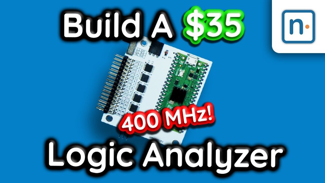

What do you do when you’re a starving student and you need a 400 MHz logic analyzer for your digital circuit investigations? As [nanofix] shows in a recent video, you find one that’s available as an open hardware project and build it yourself.
The project, aptly named LogicAnalyzer was developed by [Dr. Gusman] a few years back, and has actually graced these pages in the past. In the video below, [nanofix] concentrates on the mechanics of actually putting the board together with a focus on soldering. The back of the build is the Raspberry Pi Pico 2 and the TXU0104 level shifters.
If you’d like to follow along at home, all the build instructions and design files are available on GitHub. For your convenience the Gerber files have been shared at PCBWay

I made 5 of these. I had PCBWay create the PCBs and populate them with everything except the PI Pico 2. I wanted to source the PI Pico 2 from a reputable source (TMEU.eu). In total, it cost me 90 euro for 5 boards, which is €18 a piece. €18 euro is $21, by far not $35.
I kept 2 and resold 3. The trigger of the boards can be daisy chained, so I essentially have a 48 channel logic analyzer for €36.
I use the 200MHz firmware. The 400MHz firmware has some aliasing problems, and I don’t need 400MHz for now. But a firmware update is a matter of seconds, so it doesn’t really matter. ;)
Don’t use a PI Pico 2 W, it doesn’t work. Just use the normal PI PICO 2.
The software is coming nicely together as well. Mind you, you can’t compare it to a professional multi-thousand dollar logic analyzer, although the sampling performance is great. I haven’t been going all out on the software, but I didn’t find anything about glitch detection. I’m not sure if it’s even feasible to do glitch detection in software, but the board does not have hardware glitch detection.
Also of course there is no streaming capability.
And in my price, I forgot to include shipping costs for the PICO 2’s, which was another €9. That brings the cost per analyzer to a little under €20.
But until now I was using an old Nicolet NPC-700 logic analyzer from 1982, which is a ‘luggable’ Z80-based logic analyser with 20MHz sample frequency. It weighs 15kg and makes a deafening noise. But it has 48 channels. And a keyboard and CP/M 2.2 too! ;) Kudos to the guys who made it, because it’s still working fine after 43 years, not even one exploding cap. Although I think the CRT might love a recap.
Basically, Dr. Gusman’s logic analyzer is a big improvement. If I ever need a real professional logic analyzer, I’m sure I will be able to justify the cost. But right now it’s a lot easier to justify €40 than €4000…
