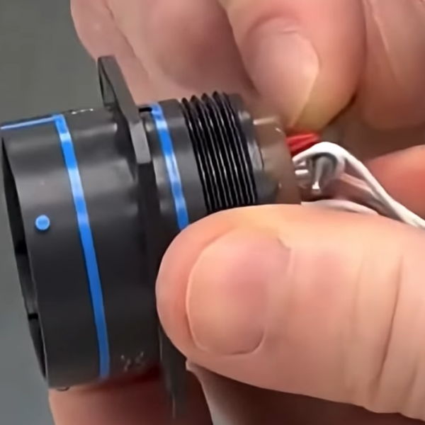

Well, here’s an interesting idea: the service loop. Ever heard of it? We haven’t!
In the video, the presenter explains the service loop serves two purposes: on the one hand it may provide strain relief, but chiefly these loops are installed so there will be extra available slack in the cable if you need to rewire it some day to change the configuration of your pinout.
One major problem with the service loop may be that the single turn is enough to create an inductor which will then induce noise and cross-talk all over the place. Our rule of thumb is always to completely unroll wires and cables before using them. Do you have a theory about the benefits or problems with service loops? If you do, we’d love to hear what you think in the comments!

This is mainly a thing (well the only time I’ve ever seen them) for D38999 (or their derivatives, anything that’s similar to mil-spec circular) connectors, where the connector and contacts can be Absurdly Expensive so rewiring them is helpful.
I was never taught to create small coils as a “service loop” in circular connectors. The extra exposed wire in a cable was there for servicing, but there is a much simpler, and quicker method to bring the sheathed area of the cable closer to the pins, and make sure it is well within the clamp area of the connector hood. Since the hood is screwed onto the connector, a counter-clockwise twist of the cable, while compressing the wires towards the back of the connector allows for movement of the wires if the cable manages to break free of the clamp. It also adds a bit of tightening torque to the hood to the connector while clamped. Of course, the wire size is important here, as shown in the video, the wires are relatively large. If the individual wire size is very small, the torque would not be as much, and the strength also much weaker. Besides that, cutting back the sheath a bit to replace pins is always an option, requiring a “service loop” to be incorporated into the cable itself.

Could you solve the inductor problem by having it go around itself and loop the other direction an equal amount?
Good question. I’m not sure! But even if it was possible it seems like it would be difficult to do right.
what inductor problem? the inductance of such a small loop is minute and anything fast enough that it could possible affect it wouldn’t be run in wires like that
Inductance would be negligible for most uses except at very high frequencies. I guess this technique is for DC and low enough frequencies, for example carrying signals for machine control and analog audio and video up to a few MHz shouldn’t be problematic.

Why would you put a service loop INSIDE the connector? Just loop some of the wire outside the connector. If and when the time comes that it needs to be rewired, chop off the connector and redo it. The larger diameter of the external service loop probably creates far less inductive issues then small loops of wire inside the plug.
“Chop off the connector and redo it”
Sure, unless the cable is already the exact length it needs to be as part of a complex wiring loom.
Also if the application is sensitive enough that the inductance of a single turn of wire will cause problems, you have bigger problems with parasitics than just this.
