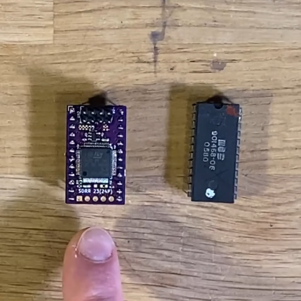

Like the rest of us, 8-bit hardware is not getting any newer, and failed ROMs are just a fact of life. Of course you can’t call up Commadore corporation for replacement parts anymore, so something is needed. [Peirs Rocks] wasn’t satisfied with the existing options, so he came up with the Software Defined Retro ROM to serve as a drop-in replacement for 2364, 2332, and 2316 ROM chips.
Physically, the Software Defined Retro ROM is a PCB that matches the footprint of the original ROM chip, and holds an STM32F4 family microcontroller with a number of extra pins facing upwards. Some of those pins are for programming, so you can flash the board in-situ without removing it from the system using a Pi Pico. The others pins are jumpers for image selection or chip configuration. Depending which STM32 you use, you can have upto 16 ROM images on the board, at whatever chip select behaviour you require. The ROM’s chip select lines could be configured at the factory to answer to HIGH or LOW, and this board can handle either with a jumper swap.
The documentation on the GitHub is very well done, for which we applaud [Piers]. Instructions and demos are also available in the video embedded below. We could certainly see this hack becoming popular in the retrocomputer community, especially as everything ages and memories continue to, uh, y’know. What were we talking about, again?

Any idea of the access times this can provide? Not sure what the STM32F446 can do with DMA but 180MHz should cover it lol.
I would’ve put the USB hardware on the board for some easy fun ICE.
The F411 at 100MHz is sufficient to replace the C64 character ROM, which I believe was a 350ns access time ROM. (On these ROMs, 350ns refers to the address line access time – chip select access time is 200ns.) I would expect the F446 at 180Mhz to be able to get down to 200ns (address line access time), but I haven’t tested with the F446 – or a system that requires 200ns – yet).
No USB because the PCB footprint is so small, and SWD covers programming needs (and I hate handsoldering small USB ports).

what about using ch32v chips? maybe ch32v006 could do it too and one can get 10 of them for $3. and they can run from 5v directly and need just two capacitors. It is ony 48mhz though so either it would need some optimization or it is tad too slow.
It’s probably too slow for, say, the C64. Might be able to cope with the PET/VIC-20, but I’m not very familiar with RISC-V and how many instructions/cycles are required for the various operations – plus what flash prefetch/cache there is). Also do these have sufficient 5V tolerant GPIOs – that tends to be quick a big swinger when it comes to fitting everything one side of such a small PCB.
some of them like CH32V006 and CH32V103 runs off 2.2V-5.5V so the gpios output 5V as logic high when running from 5V. so yes they are definiltely ‘tolerant’. CH32V103 runs up to 80MHz
It might be viable then. Probably depends on any flash wait states or flash prefetch buffer/instruction cache. Both prefetch and cache are really good on the STM32F4. My guess is with the 80MHz variant you’d be able to get it working with the PET and VIC20 but maybe not the C64.
