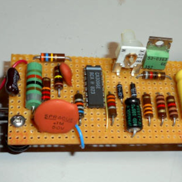

You would think detecting lightning would be easy. Each lightning bolt has a staggering amount of power, and, clearly, you can hear the results on any radio. But it is possible to optimize a simple receiver circuit to specifically pick up lightning. That’s exactly what [Wenzeltech] shows in a page with several types of lightning detectors complete with photos and schematics.
Just as with a regular radio, there are multiple ways to get the desired result. The first circuits use transistors. Later versions move on to op amps and even have “storm intensity” meters. The final project uses an ion chamber from a smoke detector. It has the benefit of being very simple, but you know, also slightly radioactive.

What is that green TO-220? And why aren’t there more of those??
I didn’t want to reply to your comment, obviously. But I guess the comment system still does weird things
The TO-220 must be the “TIP32 or similar” PNP power transistor. All the other transistors are in the “venerable” CA3096 transistor array IC. The text even says “…the transistor in the array can’t handle the current. I added an old green (PNP) GE power transistor to handle the additional current”
Not TO-220, even OLDER than that. I believe the circuit had a tube or two and fancy custom-made VU … pardon … LI meter (Lightning Intensity or something). It was fairly obscure product that never had much of a market and the company that was making it faded after selling like few dozen units.
Obviously, it was not exactly the detector it purported to be, and funny has it, the spare LI meters can still be occasionally found on them ebays. I obtained like 5 or 6 VU/LI meters years back out of curiosity, heavy chunky solid metal cores instead of pressed-powder, etc.
I had a PDF of the web page somewhere, gotta dredge up layers of internet dust particles. I’ll see if I can locate it among the noise.
Clearly Matias and I are not referring to what you’re talking about, as his reply indicates.
