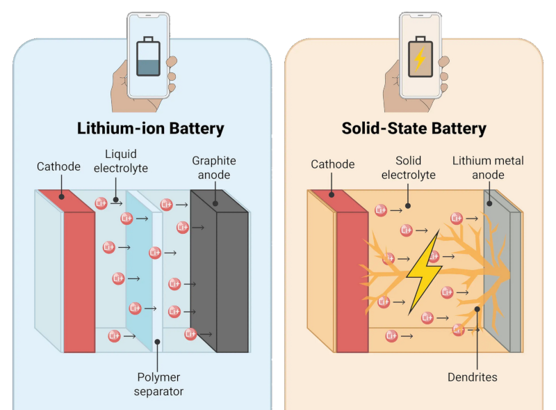

Solid state batteries, we are told, are the new hot battery technology that will replace lithium-ion batteries. Soon. Not that we haven’t heard that before. One reason it isn’t dominating the market today is that it’s prone to short circuits during charging. [Dr. Yuwei Zhang and others have published a paper detailing why the shorts happen, which could lead to strategies to improve the technology.

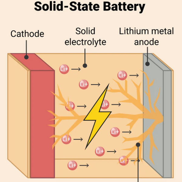

Solid state batteries employ a solid electrolyte and a lithium anode. It is known that, sometimes, lithium metal from the anode forms dendrites that penetrate the ceramic electrolyte and cause it to crack. This is somewhat of a mystery as the lithium is a soft metal: to quote [Zhang], “like a gummy bear”.
There were two leading hypotheses for the observations. [Zhang’s] team showed that hydrostatic stress made the lithium dendrites act like a water jet, enabling them to penetrate the hard ceramic.

  2. This seems backwards. Lithium batteries with liquid electrolytes and plastic separator membranes have been extremely well documented as having problems with dendrite growth piercing the plastic separator and causing shorts that lead to runaway heating. Solid state batteries on the other hand, with their solid electrolytes are supposedly so resistant to dendrite growth that they’ve switched to solid lithium metal electrodes instead of lattices which merely hold ions, which is where solid state batteries generally get their doubling of capacity vs traditional cells.

    1. The dendrite growth in liquid electrolytes has a different mechanism – it’s essentially lithium crystals growing out of the SEI like dandelions growing through asphalt.
      In solid state batteries, the dendrite growth is a result of the solid electrolyte forming tiny cracks due to mechanical stresses, and the lithium metal squeezing into those cracks until it bridges the cell.
